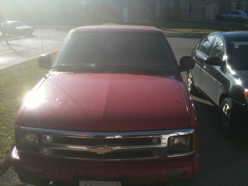

Got myself a winter beater here in Ontario...'95 S10 ext.cab 4.3 (code Z) 3500NV 5 speed manual.
