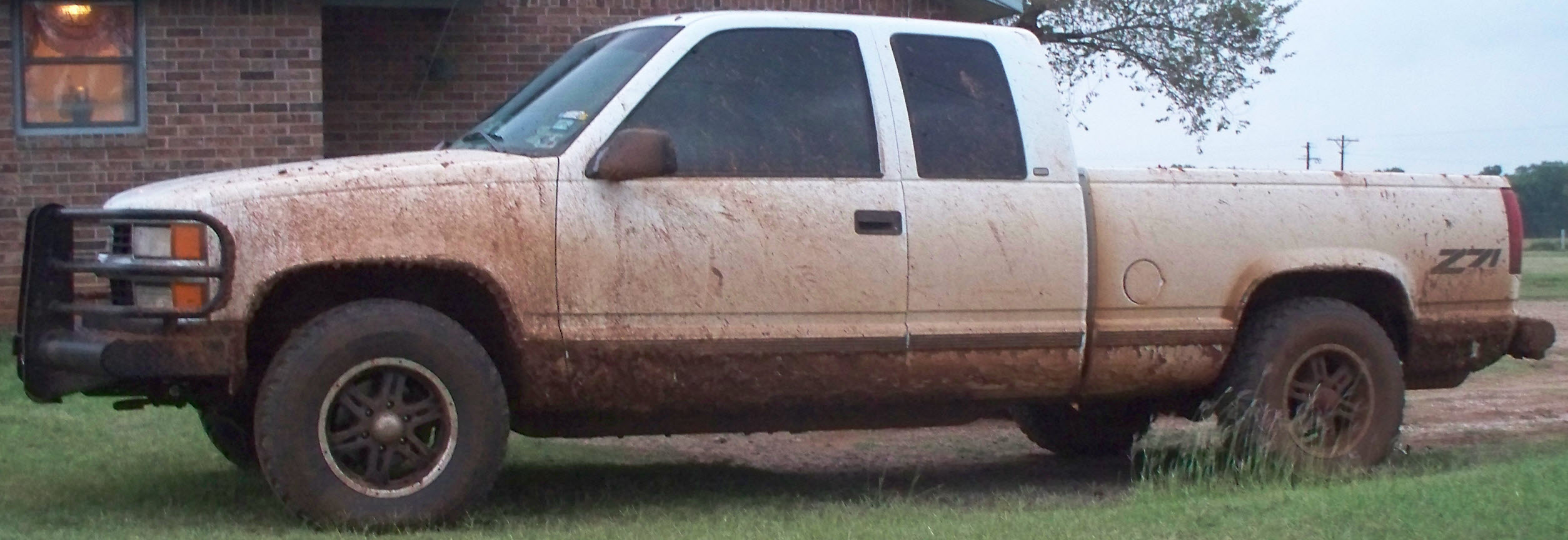

Well this is my first post, so here it goes. I had a brand new gm long block swapped after the old one finally gave up the ghost @ 173,000 and some change. My question is this, Ive had the SES light on before the new motor went in and it was for a catalyst deficiency. Obviously the computer is still throwing the catalyst code so I figured its either a bad 02 sensor(s) or I actually need new cats. Im guessing that its probably the cats, since theyre roughly 12 years old. I was wondering what the advantages were to having a hi-flow catalyst system versus just stock replacement parts, other than sound level. I found a link here on the net, http://www.racepages.com/products/?N=11920...9925+4294967257 , The one I think i need is at the very bottom of the page, but im not an expert so who the hell knows what I need. Any suggestions, comments. Oh, also looking into getting a nice set of extremely low maintenance headers (if such a thing exists). Thanks again. maybe i can attach a pic of my ride, cross your fingers
