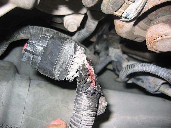

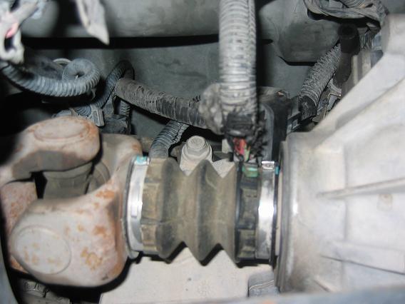

The powertrain control module (PCM) has a CAN bus to communicate with other devices on the truck and to the 2wd/4wd selector switch. On my truck my select switch started to display 4wd hi occasionally when turning on the truck. Then one day it displayed 4wd lo and I got the "Service 4WD System". I looked under the truck and the wiring harness to the TC was damaged by the front drive shaft. The tech who serviced my truck left this harness off/loose and the wires were stripped by the rotating drive shaft and shorted out.

I believe this was a communication error and I did not add "rebuild" in front of the service for the tranny. At 76k miles I had my tranny rebuilt at the dealer because of a worn down 3-4 clutch. At 83k miles the torque converter was going in/out of lockup. When the dealer pulled down the pan it was in their works "full of metal flakes". I did not have a chance to go see how much metal flakes but they replaced the torque converter and did a complete fluid flush. Later on I got issues with the 2WD/4WD switch indicator and thought maybe it was the switch as other people have indicated in the forums. But then when I looked under to make sure the connection was ok I saw the harness sitting on top of the front drive shaft. The metal crimp on the boot of the front drive shaft had cut into the harness and stripped the lower wires insulation and caused a short. The dealer fixed the harness and admitted it was not correctly routed. I attached a couple of photos for reference.
In conclusion I think it would have been better to say just check the harness to make sure it has not been damaged or simply nothing at all.
