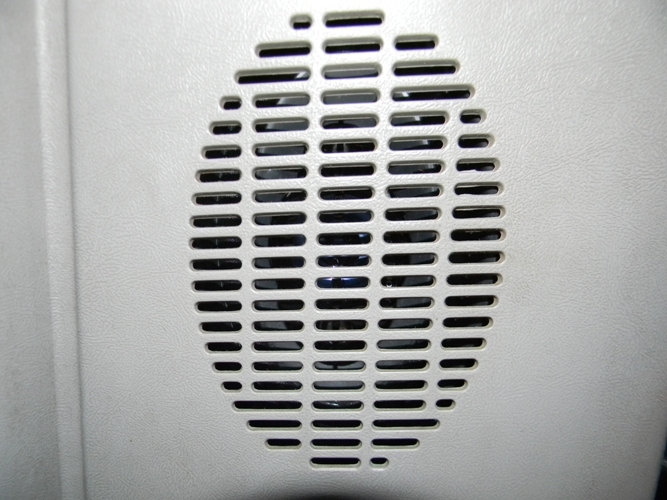

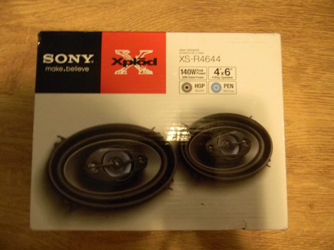

Hey everyone, just got done putting new sony x-plod 4"x6" speakers in the rear of my truck! Talk about stressfull! I never thought it was really that much of a pain until i looked up the procedure on the internet, people breaking plastic parts, losing metal clips. Anyways i figured i would share how i accomplished this, the first thing you want to do i make sure your not in a pissed off mood, because trust me i won't be good, start by removing the rear bench seat, just remove the two bolts holding it in place, then take off the plastic peice that is at the base of the rear window, just pull it towards you until all clips are out and then push it upward to release the top clips, next remove the top plastic headliner peice, pull down carefully and try to bow it so the middle buldges towards you and pull slowly to pop out all the clips, once there out push up on the ends to free them, there should be two plastic tabs holding the unit in place, and remove the peice, next is the tricky part grab on to the side panel where the speaker is and give it small tugs to remove the clips, and pull it towards you until you have about a foot between the inside of the panel and the speaker. While holding it with one hand take your 1/4 socket in the other hand to remove the speaker, unhook the plastic connector and put it through the seat belt opening, this will help you splice the new wires. On your connector the plastic tab will read A & B, A is positive and B is negative, when you are done pull back the panel, connect the wires and screw the speaker on, and pop the panel back on, now just turn your stereo on and set the balencer to rear and to the right or left (which ever one you did first), and test it, make sure it sounds right before you reassemble. Now just repeat for the other side. Oh and another tip for reinstalling the panels is, put all the clips in the panel first, then pop them back on, its much easier. Then just put the rest of the panels on in reverse order, bolt the bench seat back in place, reset your stereo and your done! Merle Haggard sure did sound good coming out of those steakers for the first time! Please reply if you have and questions, Thanks for looking!
