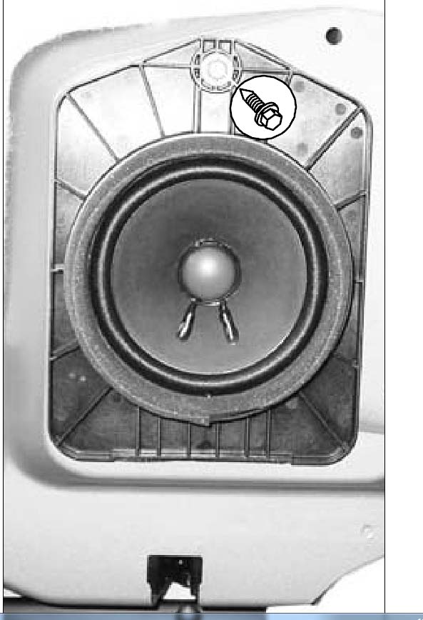

As for the rear speakers, lots of threads on them. They are this weird bracket setup similar to the front but I dont know of any aftermarket bracket upgrade like the fronts. I have seen people put 6x9s in there but you will want to make something custom otherwise you will have much of seal. Attached is a pic of what the factory looks like. I personally didnt bother. They are so far from the ears and muffled by the seats that I perfected to put more money into the fronts. But that was just my personal preference...
