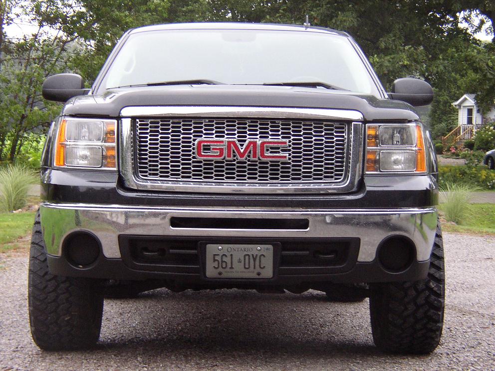

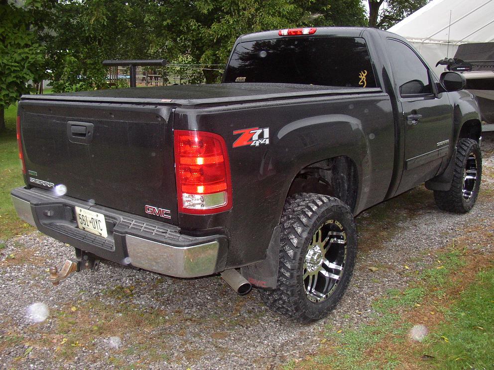

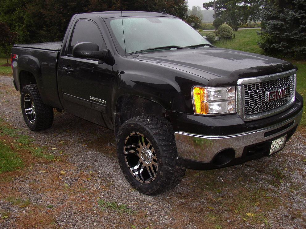

Well my rims and tires finally came in so I got them installed today, I think the truck looks pretty good, the rims are 20" eagle alloys 079 with -12 offset and the tires are Nitto Trail Grapplers 295/55/20 the truck has a 2" leveling kit and a 2" block in the rear and a 1.25" bl and I still had to get the tire place to do some trimming to get them to fit, the pictures are a little shitty since its raining and getting dark but I will get some better ones when shes all cleaned up.

I will get you a picture of the front of the truck tomorrow morning, I thought they were going to stick out a lot further then they actually do, and I love the trail grapplers, the last tires I had were 275/55/20 firestone destination a/t and they were also a nice tire, the nitto's seem to have a nice ride, a lot smoother then I first expected. The noise is not that bad at all, you do notice them a bit but I have definitely heard a lot worse, if you have the radio on low you can barely hear them. I havent really had a chance to test the performance to much but it was raining pretty good and they didnt have a problem with the wet roads, they are definitely a sharp looking tire, they look a lot beefier in person. I have noticed a little difference in gas mileage I was usually getting around 17.5 mpg around town and now I have been getting about 16 mpg but I kind of expected that with getting the bigger tires and rims.

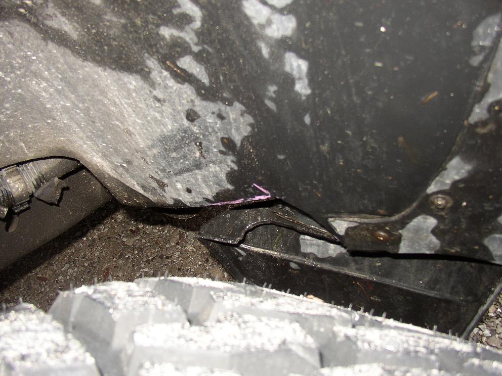

With a zero offset and this size of tire they will probably still rub a little, with mine they had to cut a little metal out, along with some inner fender liner and a little bit off the mudflap just because I wanted to keep them on, but you can only see the cutting when you look inside the inner fender so it doesn't bother me to much.

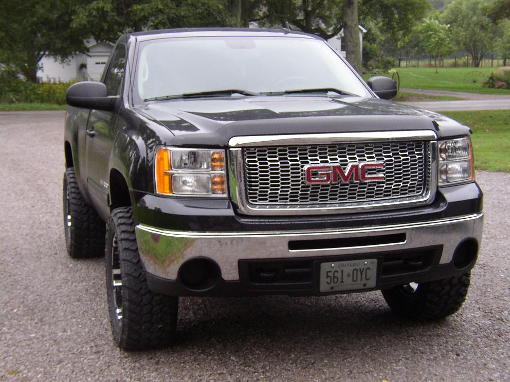

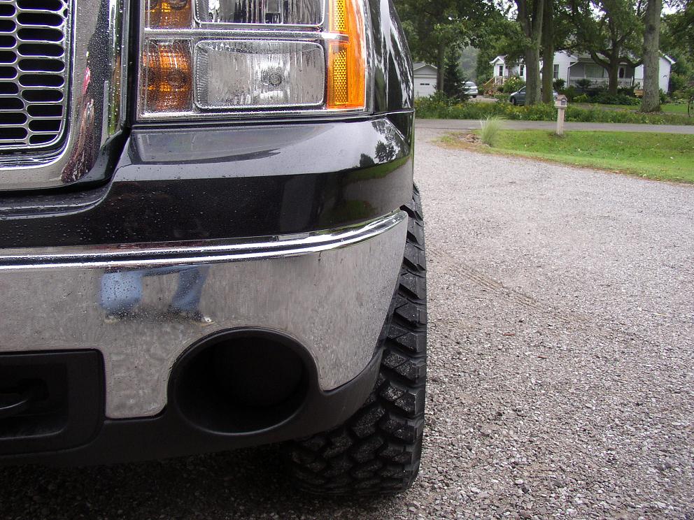

Here are some pictures from the front so you guys can get an idea of how far they stick out, I thought they were going to stick out a lot further then they do. And there is also a picture of the cut that had to be made.
Just curious, did they have to trim metal for it to fit, picture looks like they just trimmed the mudflap? I'm looking to do a 1.25 body lift and I have -12 o/s wheels and just wondering about fitment. Thanks.
That is a perfect stance and offset. :fume:
I am interested in your setup because your tires and rims with that offset will be about 4mm different then mine with lift spindles. It gives me a clear understanding of what I will look like.
Really nice honestly.

Ya they had to trim just a little bit of metal.
