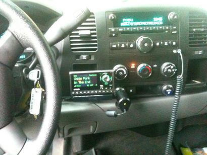

Sirius Custom Install
Looks clean but ya, did you think about wiring in a plug? Would make it look really clean if you did, shouldnt be that hard I would think.

...custom install= not using cigarette plug......

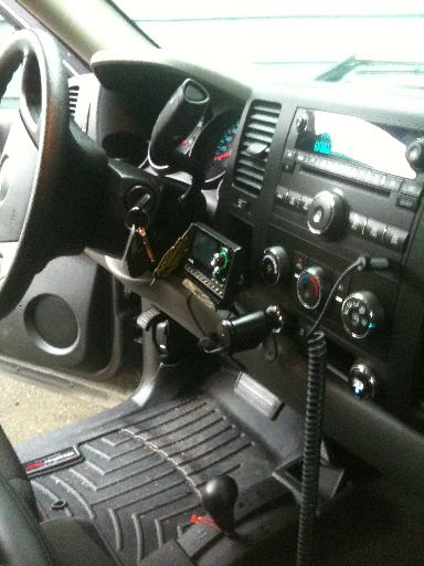

I agree. I soldered wires to the Sirius lighter plug to the switched power lead from the fuse box and a ground wire so I never have to turn the Sirius unit off or on, once I turn the key it's on automatically, and hid all my wires, only one shown is the aux wire and drilled hole in the plastic pocket that can't be seen when sitting in the truck, I made a bracket out of aluminum that I painted black to slip the player onto the ashtray tabs with a piece of foam. I'm happy with it, easy to reach too, and far enough away from my gas pedal leg, no issues..
So this is my homemade custom install eh', here's some pics to share..
