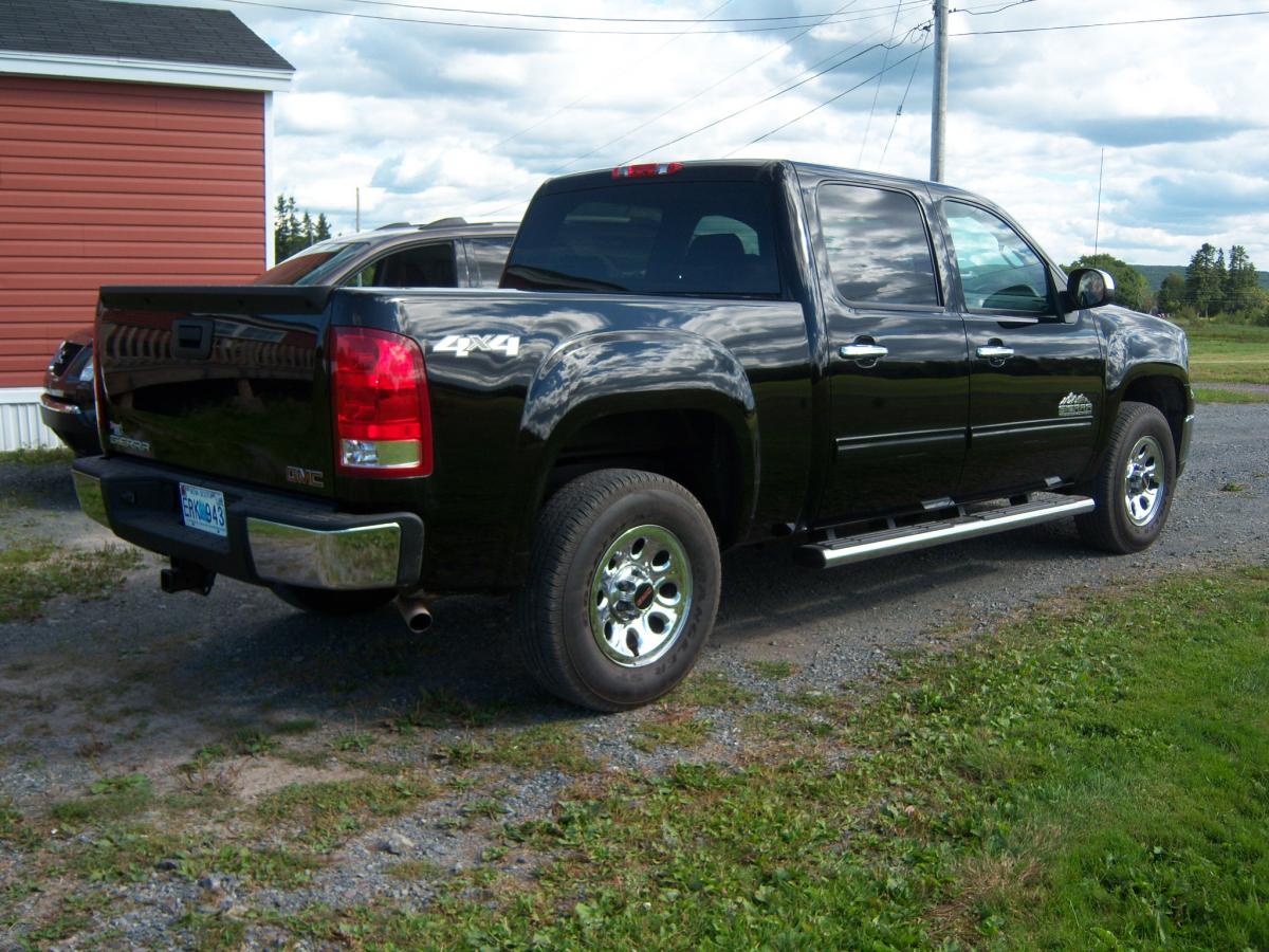

I am looking to lift my 2012 GMC 1500 4x4 and want a lift that will allow me to use my stock 17" steel wheels with a 33" tire size. will my wheels work with the rancho 4" lift? has anyone run these wheels with this kit?
My old setup with the stock 17's over Rancho. Tires at the time were 33" Toyo MTs
no wheel spacers necessary in the front.....the lift pushes them out about 1.5" either side anyway. I put 1.5" spacers on the rear to make the front/rear track width match.
