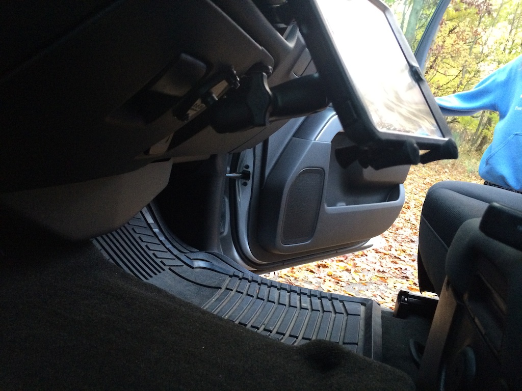

This is my third install of my iPad mini (64GB with Verizon service). I had it in my 2011 RAM and also on my boat.
I use RAM Mount components and they work great. As my Chevy does not have the center console I used the "ashtray" compartment under the radio to mount the iPad Mini.
You can get all the parts on RamMounts website, and in my case I used:
- 1" ball with diamond base (two screw holes)
- 3.5" extension
- Ipad mini X-Grip mount (work with or without case - OtterBox Defender in my case)
I took maybe 30 minutes to do it...I pulled out the compartment tray/ashtray out and went to the hardware store as I needed 2 screws, washers, and nuts. One screw is facing out, one in...One screw did not have enough clearance to accommodate the nut and still keep the tray latched. Not a big deal, unless you look closely.
Went to BestBuy and found a coiled 3 foot iPad charging cord, which is only 1 foot long and it works great (not on the pictures)
Now, I have the iPad paired up with the head unit for music and I can use Google Maps or iPad built in navigation. I have used it for 4500 miles so far and the mount is holding up well.
On the boat I used the larger base with the 1.5"ball as I wanted to make sure it is strong enough to sustain boat/waves movement. It works great for music, weather forecast, and navigation.
