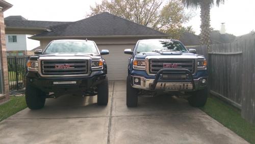

I can tell you on my brothers Black Widow, the blue truck the tow hooks were removed to install the bull bar.
Thanks. Sorry meant to type "can't be reinstalled". Fixed original post. So if my sight is not failing me, it looks like the brand of bull bar your brother installed goes directly into the holes of the tow hooks, whereas the Westin installed underneath the bumper but still requires the removal of the tow hooks? Or is that just the illusion of the photo?
On my brothers the bull bar mounts into the holes where the tow hooks "were".
Luckily my truck didn't come to with tow hooks so when I bought them I installed the bolts the only way they would fit, had to hammer one in tho. When the time came to install my go rhino 3171b push bar the way I had my bolts really helped c49e4e056b9177a8c370471c895a7d21.jpg

^^ that's a stock grill painted black ? I like it. What light bar is on there
Is black plasti dip, is held up for almost a year now. The light bar is a no name brand just a 20" 4d 5watt osram led
