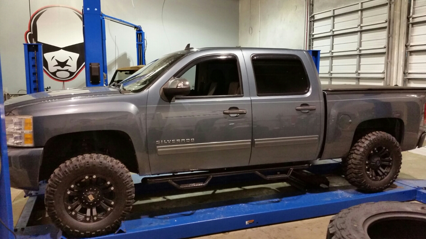

I'm running the rough country 3.5" lift with upper control arms on my 2009, it's a 2wd, the kit for 4x4 comes with differential drop spacers and you can get it with or without upper control arms. Front is a little higher than the rear using the blocks in the kit. Nice kit, rides great, clears 33x13.50 18 mtz's with rear fender mod.
