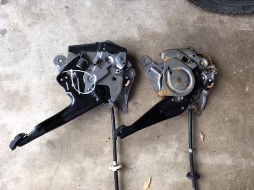

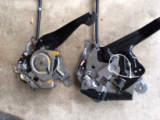

I did some research and it led me to believe the auto adjusting mechanism in the parking brake control assembly was bad. I ordered a new AC delco brake control assembly 25780186 that was listed for my truck. It actually looks different but it looks like the assembly was replaced by this newer model as the original part number is no longer available for sale.

I replaced the control assembly and the intermediate cable but there is no change in my issue. I still have about 6 inches of slack in the cable and there is no tension on the parking brake pedal and it doesn't spring back.
There was a pin that was on the new part that holds back a spring of some sort, I pulled that out before I installed the part but I was able to replace it by bench mounting the assembly and pulling on the cable with my hand to reload the auto adjuster and replace the pin.
Im wondering if I cratered some other spring when I pulled the pin and that spring can't be reloaded?
