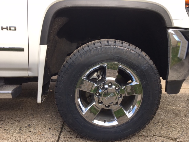

Hey guys so I put a rough country 3.5 lift in my 2015 Chevy Silverado 2500 HD. originally I had a level kit in it and ran 285 55r20. thinking about putting a 295 60 R 20 which is a 34 11.5 I have a 0 offset... Wanting to hear people's recommendations previous history's and wondering if that would rub or not it would be greatly appreciated if you guys respond thank you.

I have 285/65/20s with a 2 inch leveling kit, I have tons of room for 295s, my tire is only a bit smaller than the 295, by 10ths of an inch. With a 3.5 lift I bet 325s would fit. I would get 295/65/20s, more side wall.
