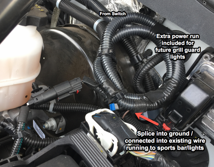

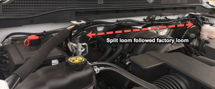

So, after looking at the lights and the pre-installed wire harness, I went with a wireless switch from Anzo.  This device has four outputs which can handle 20 AMPS each.  Each light runs just under 4 AMPS and the preinstalled wire harness was 16 gauge, which is enough gauge so I didn't have to run a different power source wire. I used the existing wire coming from the sport bar/lights and spliced it to the #1 switch power source.  I'm going to put a grill guard with lights very soon, so I ran a second power source near the front of the truck to make hook-up simple. Looks good, works good and I didn't have to cut into the dash or mess with the fire wall boot. Only thing is I'm not able to use a factory switch and have to use a fob, which fits nicely in the center console.  All in about $200 (local vendor had clearance deal on the Rigid lights) and a couple of hours time. Much cheaper than the GM Quote of around $1300 installed. Thanks for the input on this thread!
