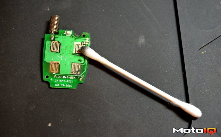

I had the same problem. Took the keyfob apart, removed the rubber button pad, and cleaned the contact points on the rubber and circuit board with rubbing alcohol. 1st cleaning helped a lot. 2nd cleaned solved the problem completely. Must clean both the black rubber pad, and the gold circuit board contacts.
I also have done that. I forgot to add it to my list. I cleaned the PCB board, contacts and the rubber sleeve as well. Problem remains and still cannot program the new key fob. Thank you for the reply starman!
