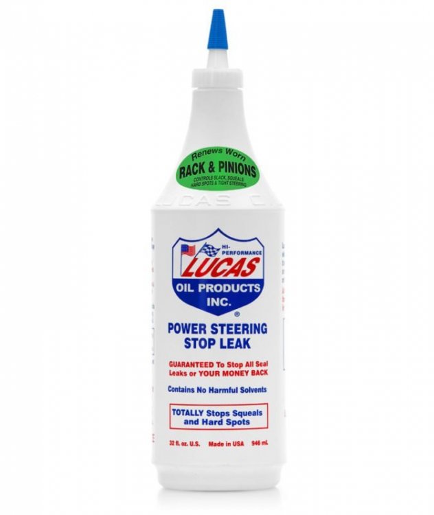

   This stuff is amazing. It makes your steering MUCH quieter and also much easier to turn the steering wheel. 1 bottle works great. Two bottles make your steering wheel "too easy" to turn. Remove some old fluid with a turkey baster ($1 at Walmart) before adding this stuff.
