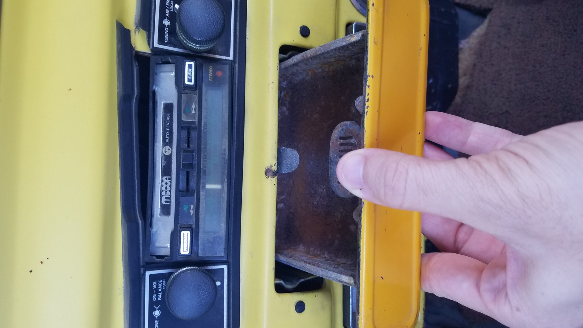

Bought used ashtray off of ebay but it doesn't fit. Am I missing something?
67-72 ashtray off of ebay doesn't fit into my 69 c20 ashtray slot?  Am I missing parts, were there different sizes depending on model or did the seller list it incorrectly?  Thanks for any info you can provide!
  • 5 months later...
Yes. There is a sheet metal piece that screws into the opening where the ashtray goes. It has the slides for the ash tray.

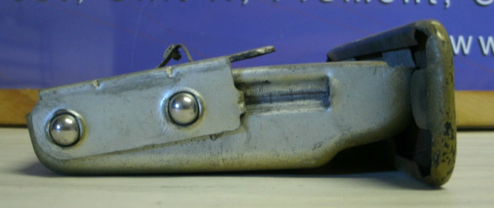

"Am I missing something" you ask for it guy- - your missing your balls, LOL. If the seller listed the ash tray "alone" as fitment for 67-72 YES He Did list It Wrong (kinda). 67-68 has a slid type slid in ONLY and the upper years or 69-72 has a ball bearing slid type, and yes both types of inside the dash mounting is also different from one another, but the Cab at the ash tray opening is all the same as long as you have both ash tray and its proper inside dash mounting piece of a matching pair it will fit 67-72. Pictures below show the differences on the two.
Yes I know this thread is OLD but it needed to have the Correct Answers. Pics were robbed from elsewhere.
