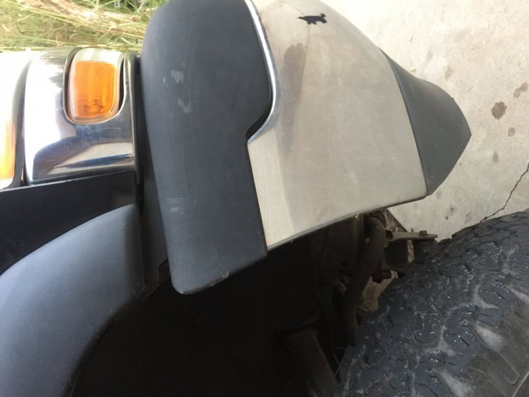

356D9004-664C-402E-BC6D-EF84CCC20BFF.thumb.jpeg.651006c348f770d20670e255938a0340.jpegHopefully someone on here has had same problem and fixed it themselves. The bumper on my 01 is sagging on the sides quite a bit. I have checked the internet and YouTube and found several videos on fixing it with all thread through a hole on top of radiator area and run it through a hole in your bumper but that does not work on my 01 2500. The whole headlight mounting area is in the way and the hole in the bumper is nowhere close.  Hopefully someone else has fixed this problem. Thanks in advance

Try loosening (but not removing) ALL of the bolts on both ends of all the mounting brackets (the bumper end and the frame end) that attach the bumper to truck. you may then be able to align the bumper by blocking it up, then re tighten everything. If there are a couple points that seem to have less play than others and they are inhibiting the alignment, get a step drill and enlarge the holes slightly, or if u need more slack in a bracket when tight, try shimming those with washers. its worked for me in the past.
