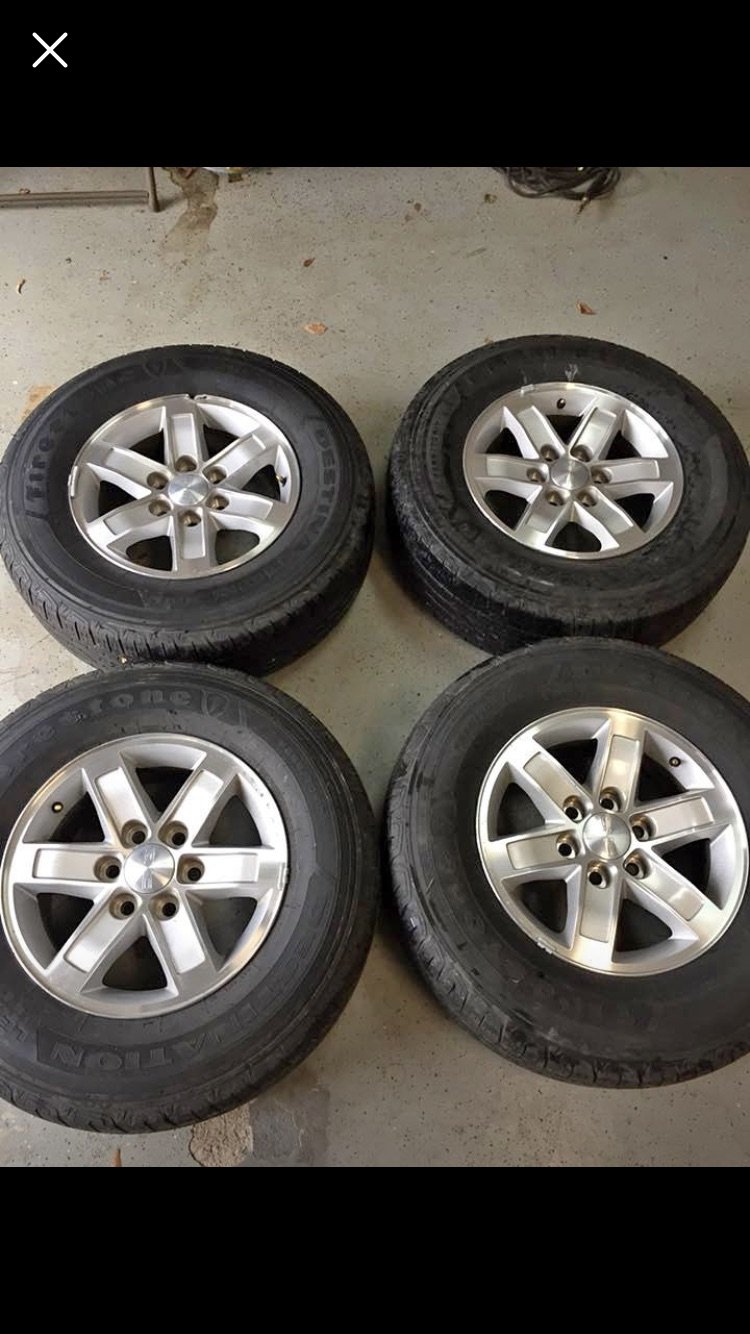

It has the steel chrome wheels and 265/70r17 tires. I want to upgrade to the later model 17" alum wheels. Will a 285/70r17 fit if I crank the torsion bars up? Is it better to go ahead and get keys or can I get it high enough adjusting the TB's?

Keys are a waste of money. You should have more than enough adjustment with the stock keys. Just don’t go overboard and have the front end aligned after
Will 285/70R17 tires fit with the torsion bars cranked up on these wheels? or will they scrub bad?
