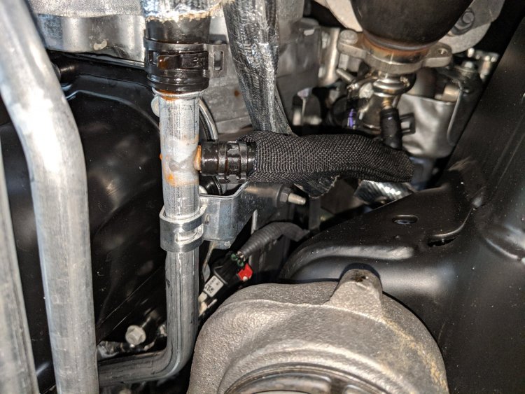

2020 2500 & 3500HD Coolant Bypass Line Leak
There is a coolant by pass line that runs on the passenger side next to the transmission that has the potential to leak.  This is just a heads up to check if you are buying a new HD truck 2500 or 3500, in my case I ordered a 3500HD picked it up and by the time I got home parked it and saw some drips on the ground.  I looked up and saw whats in the picture, so if I do encourage everyone to take a look to make sure.
