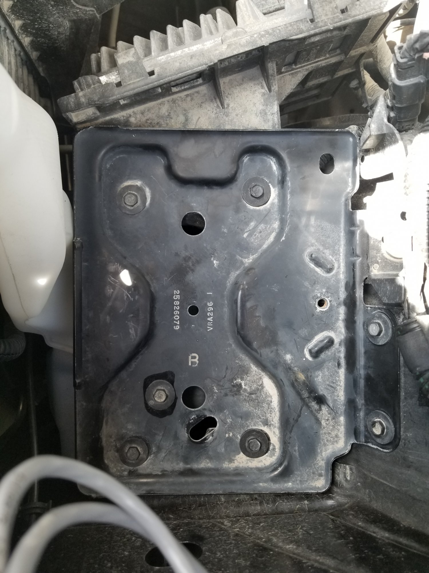

I was looking for the aux tray for the 2019 Silverado LD/2018 carryover and with zero help from the dealer and to many chances buying blind online....off to scrap yard I went.
Found a tray from a 2015 Silverado with an aux tray, GM part number 25826079.
Looked correct, until I got home....
Only 1 difference...the slotted hole to mount the washer bottle
Some quick drill and die grinder work, and some touch up paint, and off we go....
See next comments for more pictures

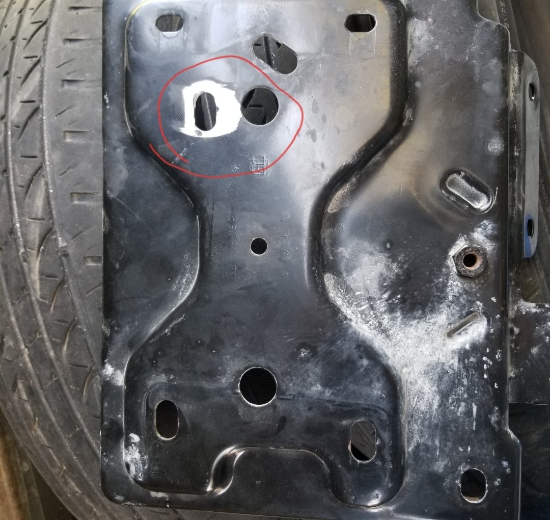

Transfer slot, drill, die grind, ready for paint
