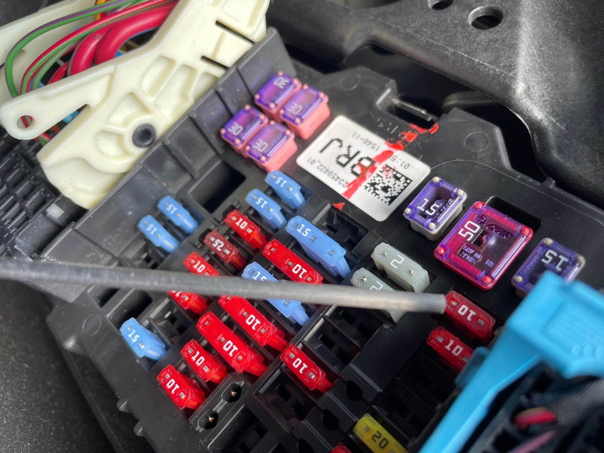

You're in luck. I just finished getting mine to work again on my 2016 Silverado.
There is a known issue with the wires that run from the console charging pad to the main harness where they get cut by the console door after many times opening and closing.
I replaced my wiring harness last night and it didnt work. I changed the 30 pink fuse on the passenger side. No luck.  Then I decided to pull and look at each fuse.  I started on the drivers side.  When I got to number 2 it was blown. Replaced it and now the charging pad, and the window work.

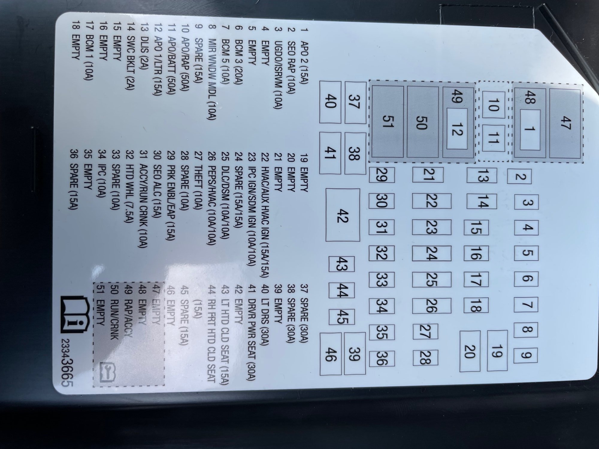

Hello,
My pictures rotated 1/4 clockwise when I uploaded them.  Number 1 is that square 15. To the right, or below in the pic, is number 2 that little red 10 that I touching with the pointer.
I found that if this fuse in my truck was blowing there was a short somewhere.
