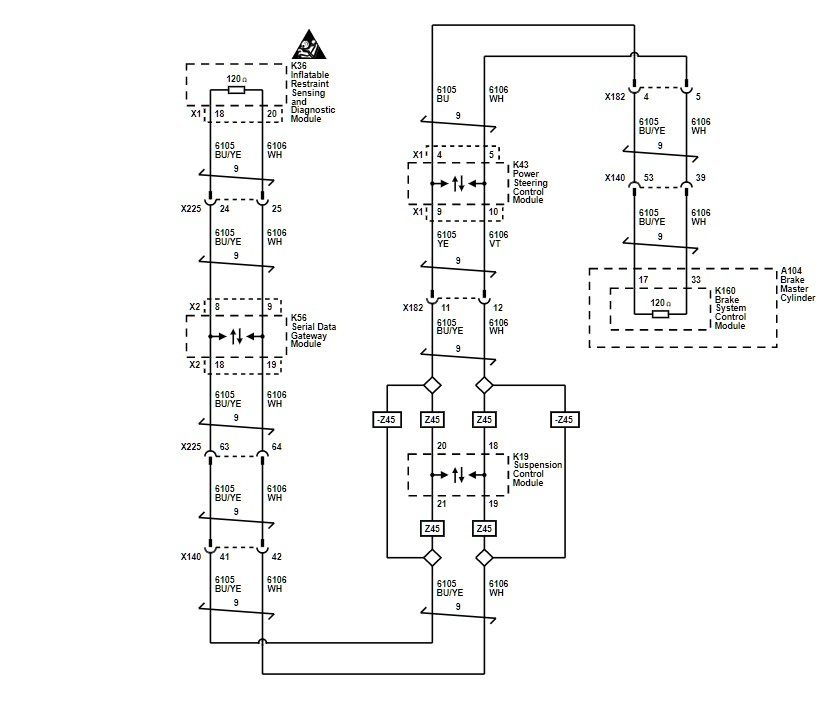

Hello. Recently picked up a 2022 RST. I’m just curious if anyone knows what the blue wire with yellow stripe/ white wire are for. I did copy the pic from another user but it is exactly what in referring to. Any info is greatly appreciated!
Long story short i was trying to cut/ peel back the black tape to get access to the speaker wires and accidentally cut right through the white wire. I did put a crimp there to re connect it. I was just curious to see what i potentially ruined
