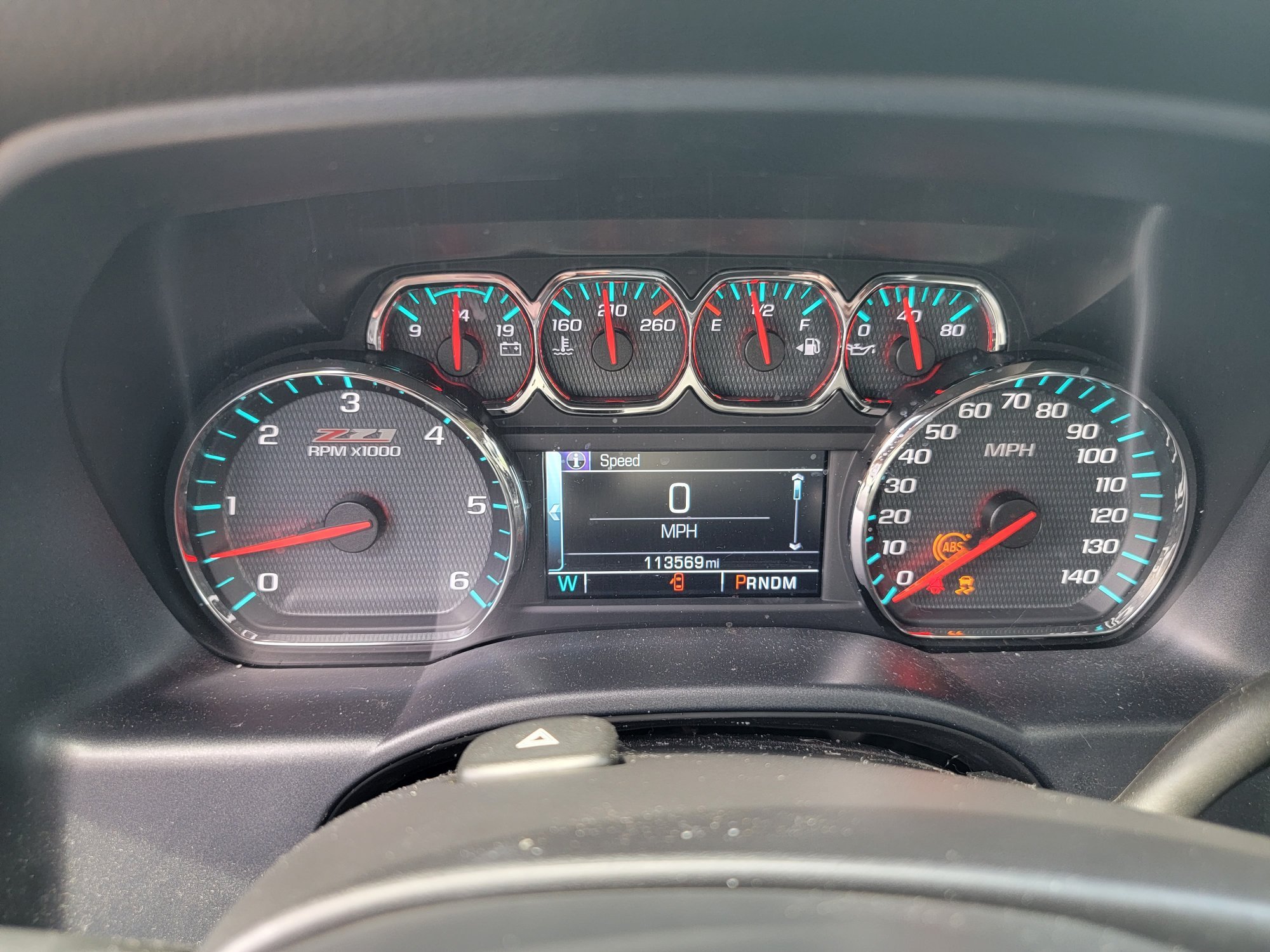

I had a battery issue a few weeks ago which I made a thread about. Now I'm back to a similar issue but I'm having a " Service Stabiltrak" and "Service Trailer Brake" pop up. I had a new battery replaced 2 weeks ago and the issue is consistent every time I start my truck. When I drive it feels like it's stuck in 4x4 and jitters, I feel I lost power steering aswell and I need to drove it in w High to drive it comfortably. The lights I have on dash are Traction Control and ABS. Battery and Alternator tested good at Autozone and Valvoline.
2016 Chevy Silverado 1500 LT Z71

My stabiltrak warning light kept coming on constantly and the ABS light also, turned out to be a broken wire on the wheel speed sensor. I have problems with the service trailer brake coming on, I havent figured it out yet, I did squeeze the things on the dash and it hasnt come back on and its been about 50 miles so far.
