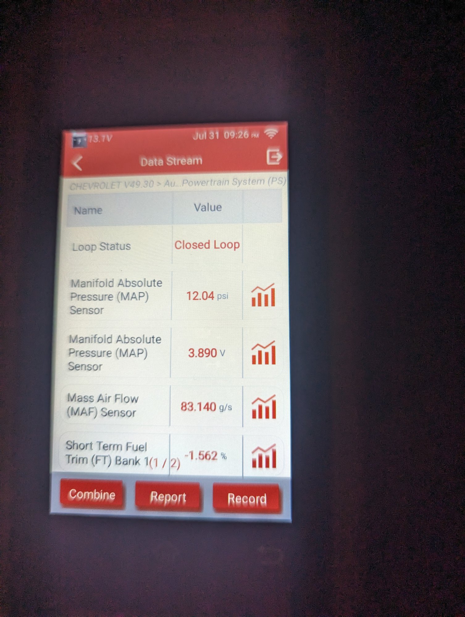

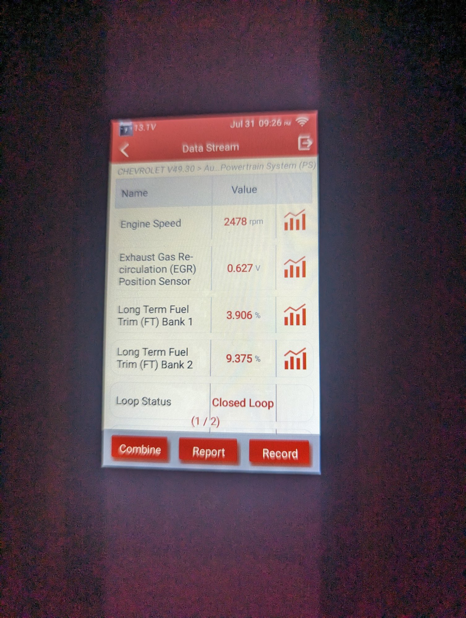

So the check engine light started coming on a lot more consistently and I pulled out a cheap scan tool which gave an EGR code, I don't remember exact code and P0302. I replaced the EGR valve but that did not help.   Started researching and found these possible causes: I also bought what I thought is a better scan tool off amazon and attached is the freeze frame of what's going on during the P0300

My thoughts on this from the diagnostic data is I don't understand how it could be a fuel pressure problem or vacuum leak because BANK 1 looks good within spec and BANK 2 seems off with that cheap scan tool bringing up P0302 cylinder 2 / bank 2.  So leaning towards bad distributor cap. I ALSO have replaced the spark plug on cylinder 2 with a new ACDelco and no improvement.  The van idles great and doesn't do the check engine light at idle, just under load. Runs good and then when the light comes on feel a slight shaking / misfire  THANKS to everyone and all help is appreciated.
