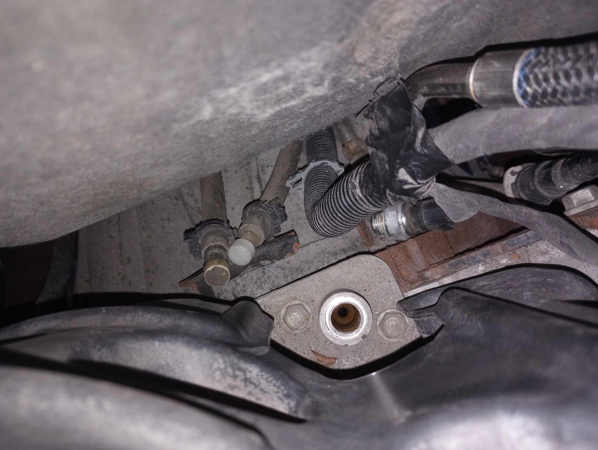

I have a 2011 GMC 2500 with the 6.0 roughly 130-140K on it.   I  changed the oil in April and just before I did I noticed that instead of being at the usual 40 PSI at idle it would fluctuate down to 20-30 PSI and when you accelerate it would come right back ( to me a sign of just really over due for an oil change).  After the oil change it went right back to normal 40 PSI at idle.   I went to start it up couple of weeks ago I took the truck in the morning and it was fine came home parked it.  In the afternoon I went to move it out of the way and noticed the oil pressure never came up at all.  I let the truck idle down the drive way and shut it off and ordered an oil pressure sensor, put the new one in and no difference.  when I was trying to determine if I needed the screen or not I took a picture and zoomed in to see if there was a screen in there or not and it appears that the bottom of the port is dry and rusty and doesn't look as if it has seen oil in quite some time.  I started the truck with the sensor out and let it run for a few seconds and nothing no oil came out of the port and when I took the pressure sensor out bottom of it was clean as shiny the the same as if I had just taken it out of the package.

i have seen videos on people replacing the sensor and some of them recommended blowing out the sensor "tube" with compressed air.  maybe yours is plugged deep down preventing oil from going up the passage to the sensor.  Just a thought.
