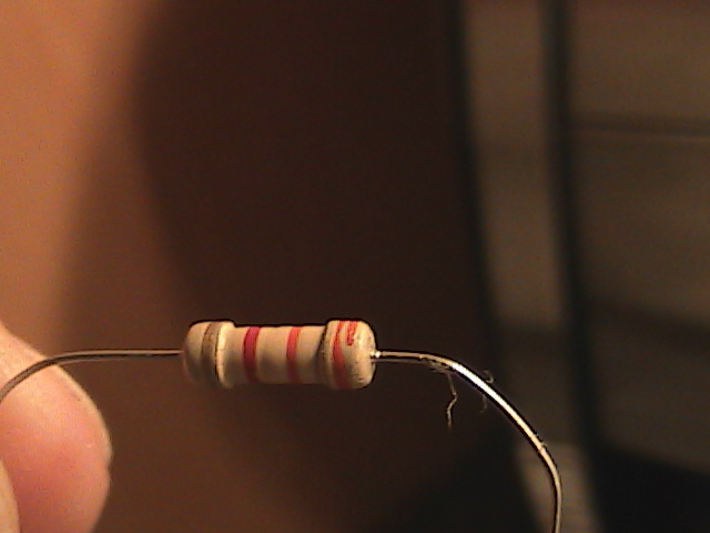

So yours is a 5.3L 2007 & instructions say it's a 3.3K ohm resistor? Ok what are the color stripes in order on the side of the resistor?
Sorry. Yes I do have a 2007 nbs 5.3L. I just double checked and the paper work does say 3.3Kohm. I can scan the instructions and see if they will post legibly, If you need me too. Good luck.

Oh and thanks for the picture.

Looks like gold, red, orange, orange.
That is a really cheap resistor. Actually the colors should read Orange, Orange, Red, gold. I am 99.9% sure 3.3K (or 3300)is correct, the gold indicates a tolerance I believe of 5%. That also looks like a 1/4 Watt model as well. If the power across is more it will heat up and fail. If this being installed under the hood and see high Temps it could fatigue it as well. You might want to think about a precision grade and more Wattage resistor, they do not cost much..........

I doubt it will fail due to overload in the IAT circuit, but if it does you will get a svc eng light and know where to look.
