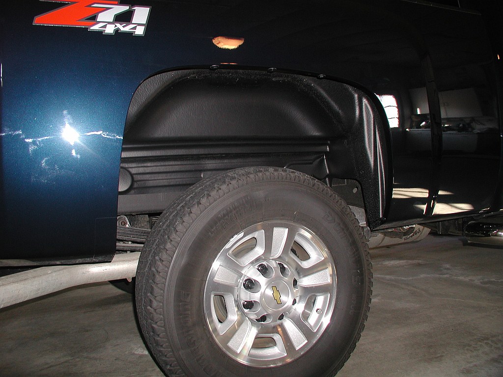

I have them and they're great. :lol:
Didn't even need to remove the wheels to install them. Like a few others here, I didn't install the screws, just the push pins in the fender lip. No issues at all. They stay in place and don't rattle.
They sure make the wheels look nice.

Well I hate to be the first negative one but.....I had them and took them out,They trap too much dirt and "junk" between them and the sheetmetal of the wheelhouse.
I also installed a set on our parts truck at the dealership and you wouldn't believe the crap that gets trapped under them,but what I really noticed was all the dirt and little stones/pebbles that gets stuck at the bottom of them,right where they meet the bottom of the bed.
They need to be cut about an inch up higher than they are,this would let a lot of that dirt just fall to the ground.
I think I'm going to take them out of the parts truck also and just scuff-up the wheelhouse and either spray some undercoating or spray-in bedliner in-a-can under there.

No,The way the front ones are designed they don't collect a lot of dirt & "junk".
Like I said,The biggest issue with the rear ones is at the bottom of them,where they meet the bottom of the bed..The way they have the liners shaped they trap dirt and little stones & pebbles.
I think if you trimmed them a little this would let all that stuff just fall to the ground.
