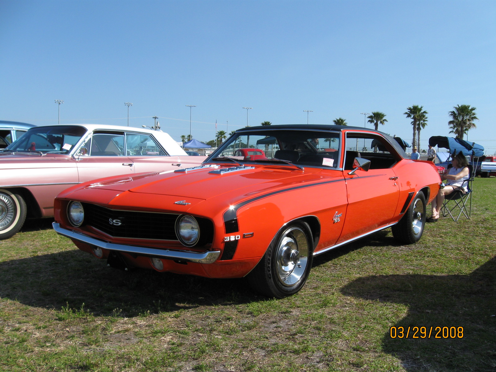

Here's a pic of my 1969 Camaro SS playtoy :lol: Click once ,after it loads then click again....
