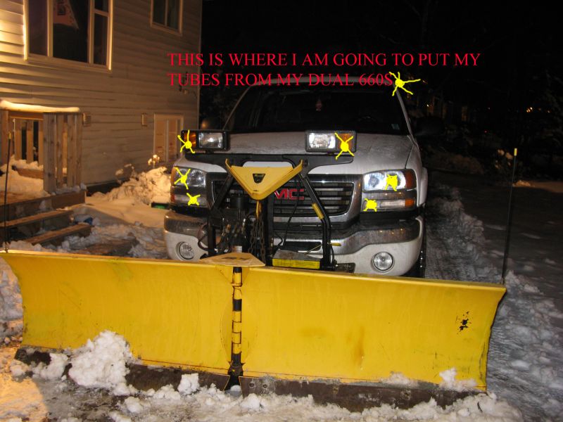

I saw it on an NBS Silverado thought it was a nice clean idea. I will be plowing a few driveways and the parking lot at my business this year. Also I often am in parking garages and I am looking for a low clearance warning light. I probably wil just get a low clearance 360 degree led stobe setup.
