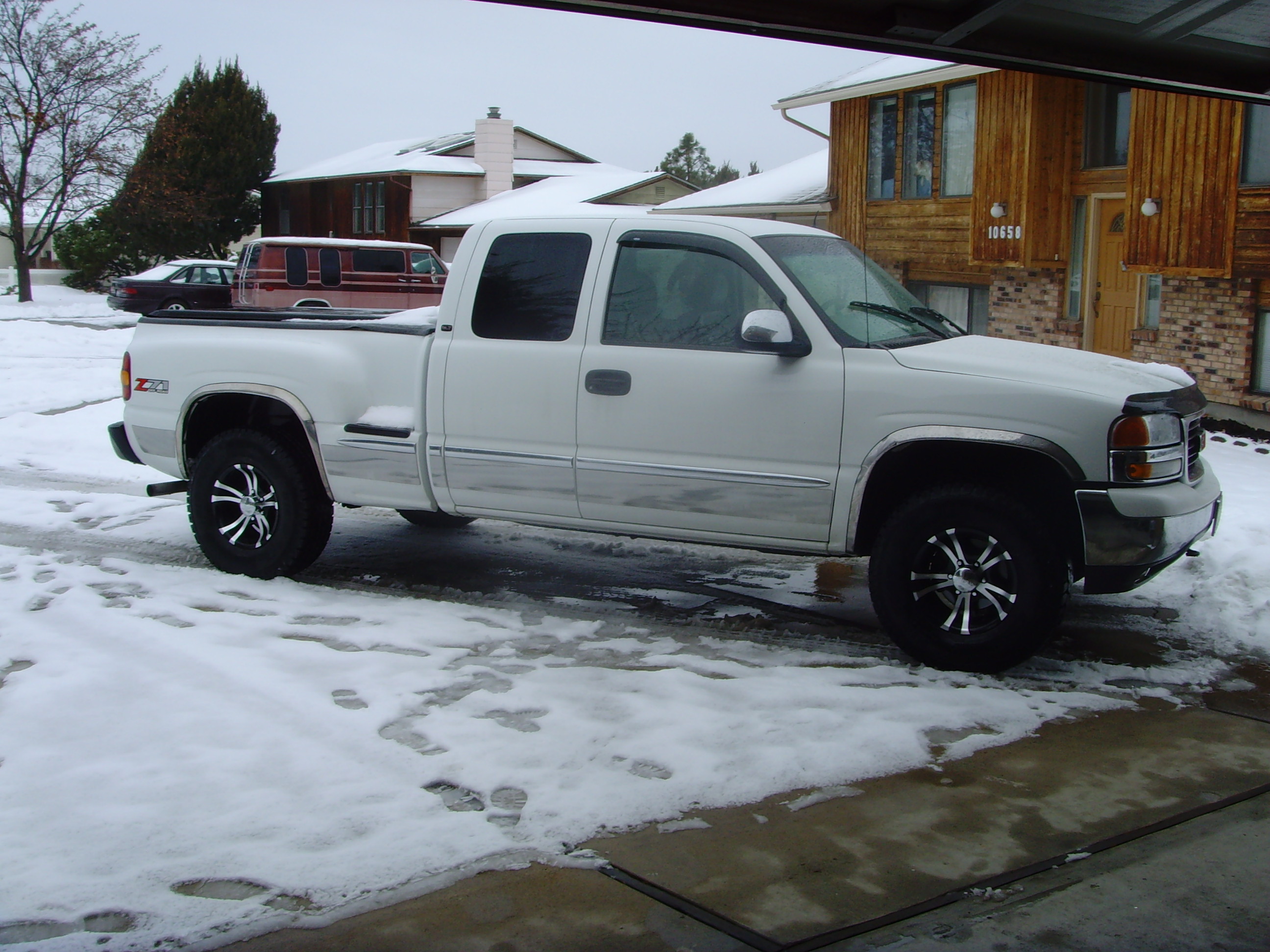

doompeak, here is my 02' Sierra. i needed to switch out tires last week and asked the same question your asking. they tried on the 285/75/16 and they fit. give me a nice lift (if you can call it that :thumbs: ). no rubbing at all...they did have to crank on my torsion bar, just a little to level the truck back out. when the bigger tires went on they caused the truck to tilt forward a little. i didn't like it that way, preference i guess...
Nice rim's what kind are they?
thanks! they are an Akuza wheel. they only make it up to 17" which i am thinking about getting. i have the 16" wheel now, but stuck on how much of a difference in apearrance it would be when i get my 6" BDS lift and 35" tires you know? i seen the Ultra brand, but don't know to much about them. i heard they just copy other wheels and sell them for cheap. but they make it from 18" -20".
