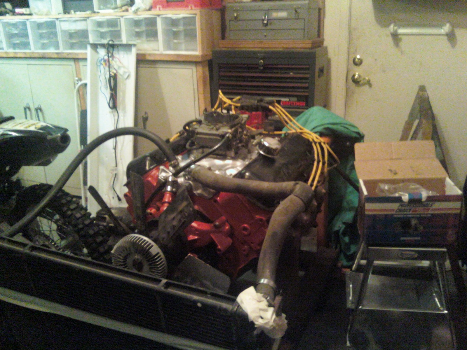

Ive got a 454 goin into an 83 shortbed with 42'' boggers, quad shocks, turbo 400, beefed up np208, dana 60 rear, dana 44 front, both with 4.88 gears. lol should be fun :lol:
and yes the geo is mine, i love it :cool:

Thanks ill just go out and buy the right one. ya im usin the HEI off my 383, so far that and i believe the starter are the only things that interchange.
ya i ran it some more today to look for oil leaks. out in my drive and my neighbors came out shitting bricks once i started reving it up!! :thumbs: my ears still kinda hurt lol.
