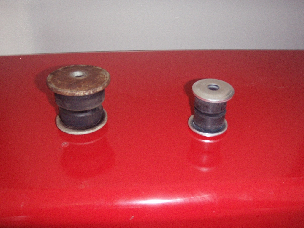

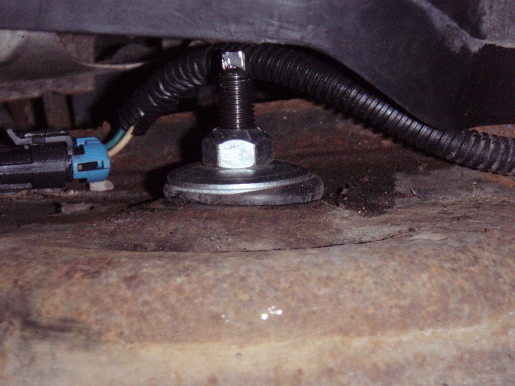

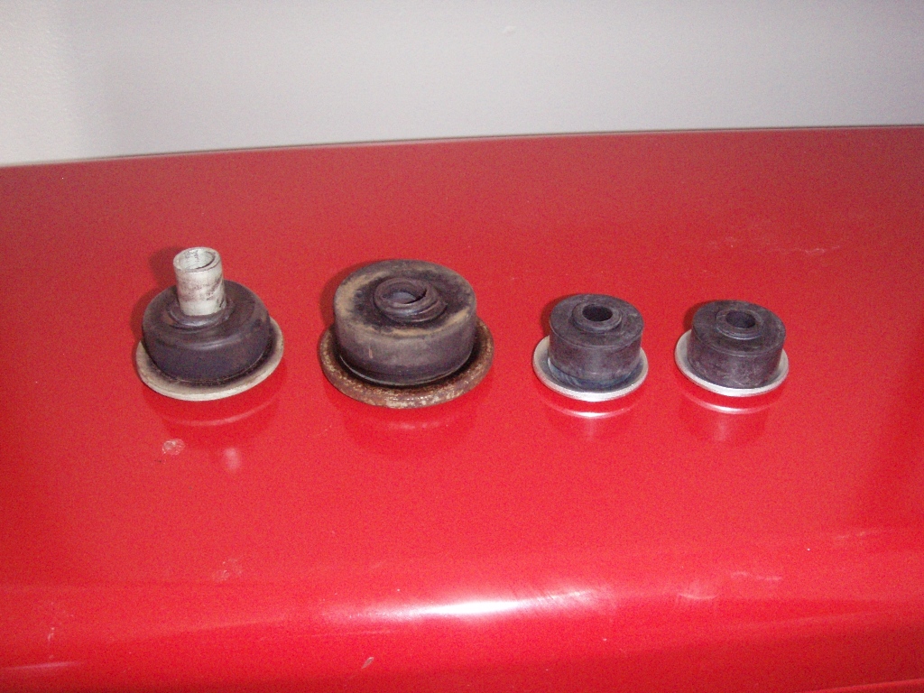

The install went well, I did change one thing. The new front shocks came with new upper and lower bushings that I ended up not using them. They were alot small than the factory ones (see my attached photos) and I didn't like how much the new bushing was compressing under load.

Geez. I can see why you used the OEM bushings. I just did a set of Bilstein HD shocks on my truck yesterday and the replacement bushings, although slightly smaller, were nothing like that.
The OEM lower bushing plate also has the build in space so you know exactly how compressed the bushings should be as you can see from the KYB ones installed I could of been too tight, but I was trying to get the bolt to torque to the correct setting. I guess the KYB's are aftermarket and the have to supply a "universal" type bushing. If I knew I was going to have to reuse them I wold of bough some new ones, but at the point today when I decided I was going to use the OEM style ones I had a truck with no wheels on it and all the stock shocks off and just one replacement one on.
