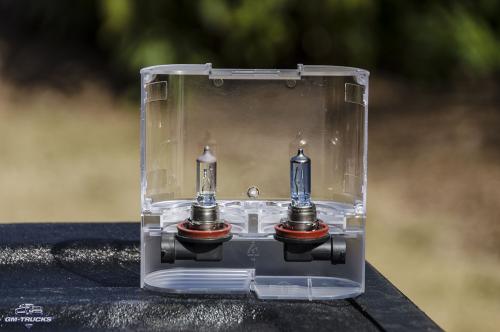

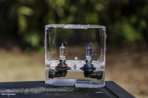

Silverstar zXe Headlight Bulbs
The Silverstar zXe bulbs are Sylvania’s premium headlight bulbs. Sold in pairs, our Sierra takes H11 for the low beams and 9005 type bulbs for the high beams.
Silverstar zXe bulbs are supposed to be the brightest and most "Xenon like" bulbs that Sylvania offers. They provide the bright daylight colored light closer in the spectrum to HID systems without going over the top and having a fake blue tint that only serves to annoy oncoming traffic.
Installation is as easy as replacing any other headlight bulb. We had the best results on our 2011 using small hands and removing the air filter assembly.

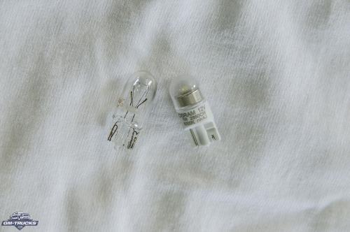

ZEVO LED Marker Bulbs
Our trucks have around a half dozen mini-bulbs used around the exterior as marker lights. In some new vehicles, these bulbs are now LED. LED's bulbs are brighter, have a high-tech look, and never burn out.
Our Sierra came from the factory with 194-sized incandescent marker bulbs that give off a dim yellow light. Even the rear license plate lighting used two of these little outdated bulbs. Thankfully replacing all of them is very easy.

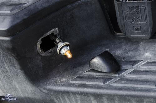

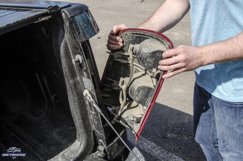

Our truck has two 194 bulbs in the headlights, two in the tail lights, and two to illuminate the rear plate at night. We started in the rear and removed the tail light housings using a Phillips head screwdriver. The license plate bulb housings pop out by squeezing a few tabs located behind the bumper. The four bulbs in the rear took under 15 minutes to swap out.
The headlight marker bulbs are slightly harder to get to. They reside on the side of the headlight housing, tucked tightly in the front fenders. We used a pair of needle nose pliers to very carefully remove and replace the bulbs up front.

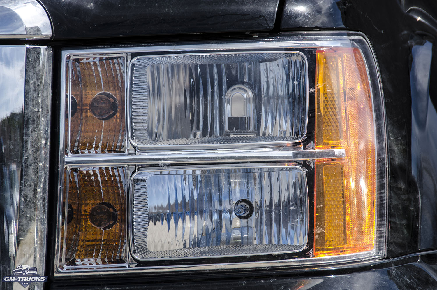

Stock vs Sylvania
The stock headlight bulbs (left in each photo) vs the Silverstar zXe bulbs (right in each photo). The Sylvania bulbs have a blue tint that can only be seen during the day.
That blue tint on the bulbs translates to a slight blue hue in the headlight housing during the day. At night the blue tint isn't apparent.
The stock 194 marker light and license plate bulbs are light and fragile. The ZEVO led replacements are sturdy and feel heavier duty.

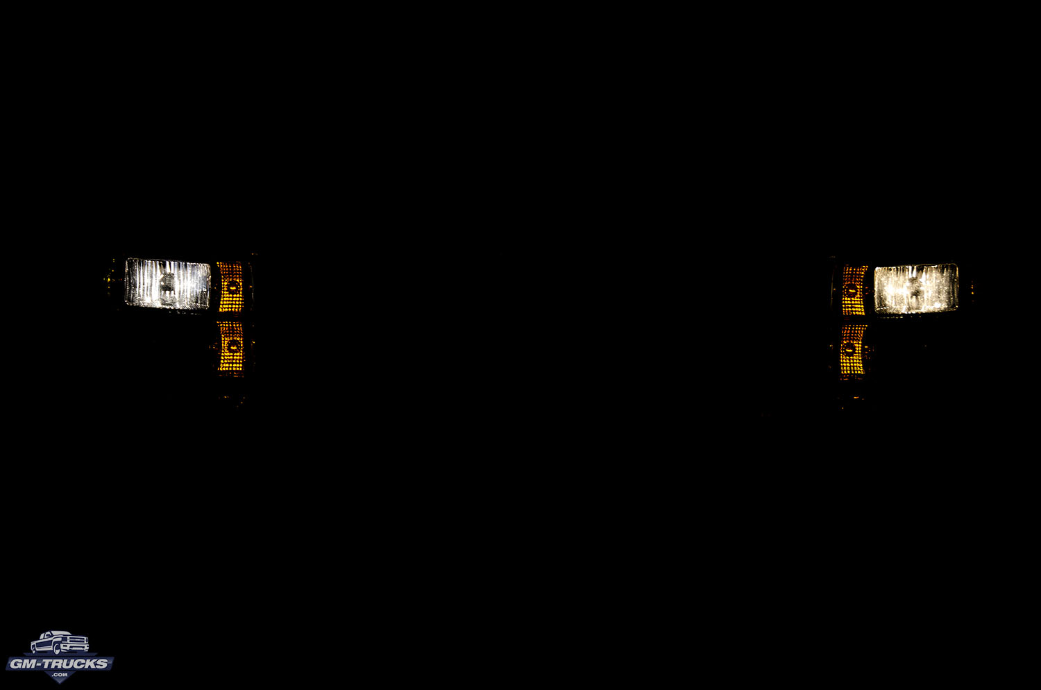

The right/driver side headlight is still stock. The left/passenger side is a Silverstar zXe bulb. The stock halogen bulb light looks yellow and dimmer in comparison.

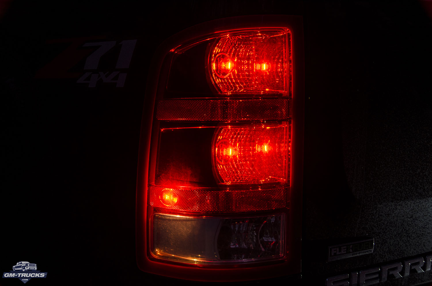

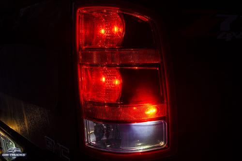

Replacing the 194 marker light bulb in each tail light is a quick job. The reward is a significantly brighter 6000k white light. Stock on left, ZEVO LED on right. The LED bulbs are so much brighter that you can see the light spilling over into the lower part of the taillight. At first we thought this might be a problem but ending up deciding we liked the more aftermarket look it gave our truck.

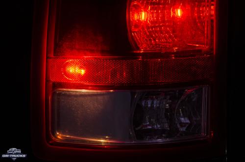

Up close, it's even more obvious that the rear tail lamps benefit from the brighter ZEVO LED bulbs. The stock marker lights are almost unnoticeable. The LED bulbs are unmistakable.
The result is the most dramatic when illuminating the rear license plate. The stock 194 bulb(left photo) is yellow and dim. The Sylvania ZEVO LED bulb is much brighter and gives the exterior a better overall appearance.
Side by side, it's easy to see the ZEVO LED bulb (left) is a big upgrade in brightness from the stock bulb(right). Since LED's never burn out, you'll most likely never have to replace them again.
