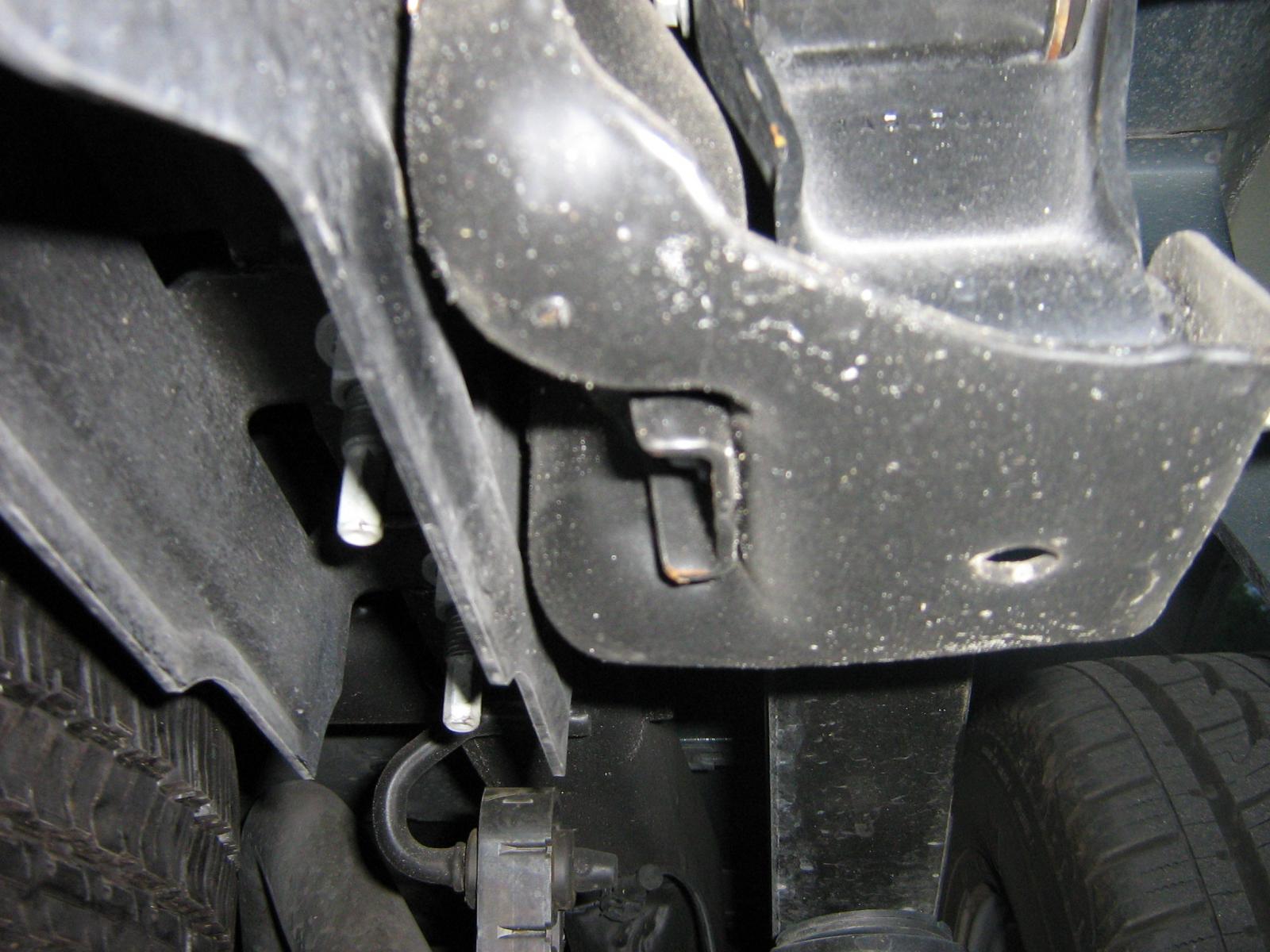

Well I've posted quite a few queries on this site about this, listened to members like Zembonez and others, got up my courage and jumped into the kiddie pool! This was my experience at this basic, it turns out, procedure. Your results may vary. A 1/2" electric impact (really speeded things up), 1/2" ratchet and extensions, torque wrench,13/16" or 22mm deep impact sockets and box ends and 3/4" wrenches/ deep sockets. A helper helps, but could be done without I guess.
1) jack up by pumpkin as Zembonez suggested, and up on strands, front chocked well
2) the hitch must come off with 4 frame nut and bolts, 4 captive nut-bolts to frame and bumper. This is the view with the hitch still in the way
then gone (actually shackle already off..)
3) remove the 4 rear bed bolts, loosen 1/2" next 2 forward and leave the front 2 tight; all have captive nuts
4)remove the 4 shackle nuts
5)with the bottom shackle bolt out after just barely unweighting it, jack up the diff untill the spring eyes push the bed up enough to remove the upper bolts- about 1". Some say instead to fold the flange or that neither fold nor lift is necessary, but something was for me. This is the spring eye touching the bed seam before lifting it any and the bolt ain't going further out due to frame interferance
5)switch out shackles both sides then reverse order. I put a bit of waterproof grease on the shackles steel sleeve and the bolt shaft, left nuts off until back on the ground, torqued them 37#, bed bolts 63# plus locktite, hitch 80#. The Belltech shackles look almost OEM quality and I like the steel sleeve vs the stock plastic bush in the dampered end. The spring eyes had a spacer or washer on the right side of both eyes-asymmetrical observation FWIW. Glad GM was first listed if not in large print. Dodge parts on my truck, dammit and the instructions pictured a Ford :lol: .
There is now 10mm gap between the seam and spring eye once bed was bolted back up. 8mm on the other side. Crooked POS!
