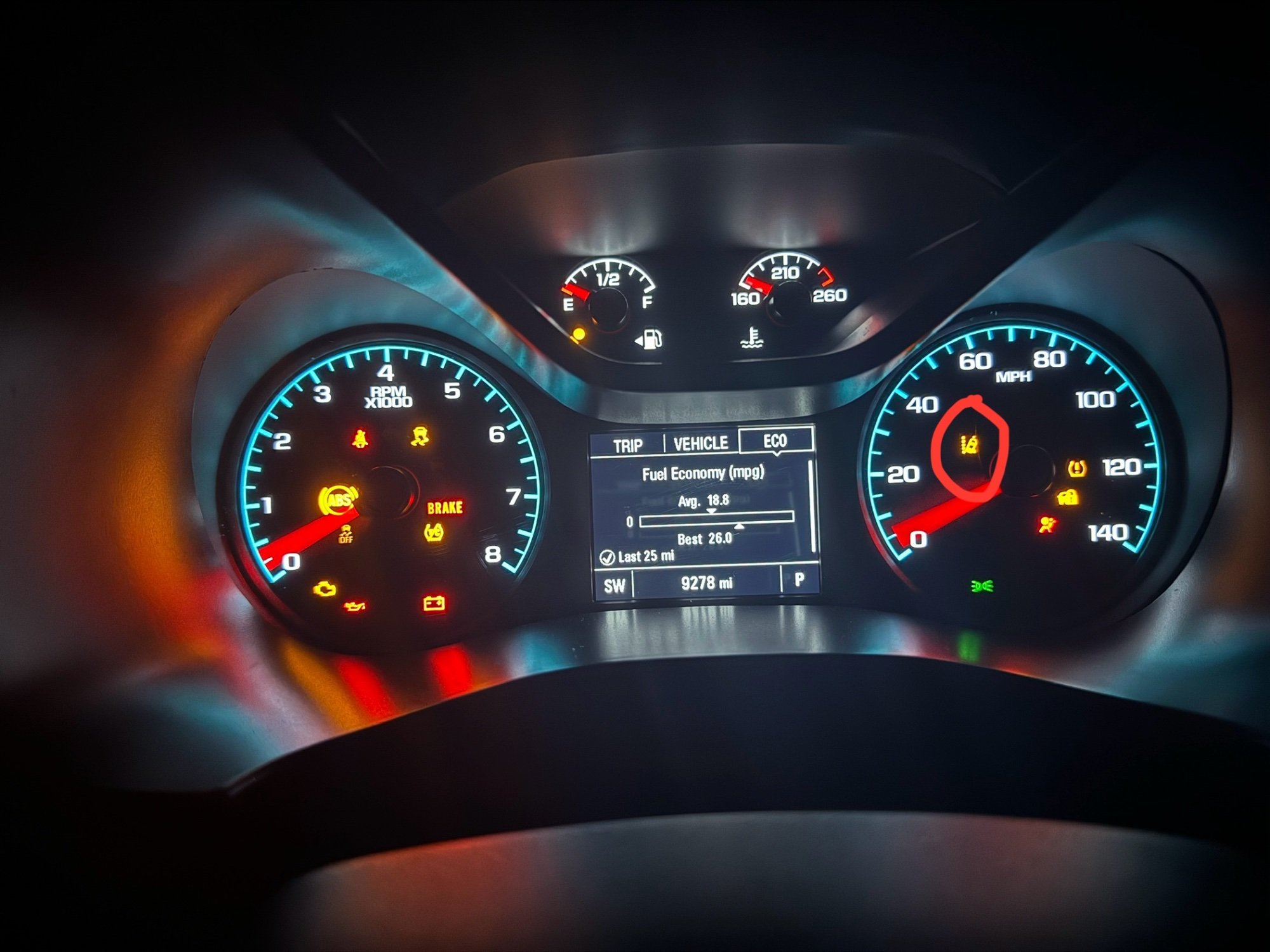

  2. 2017 Colorado wt, 2.5L longbed, base level. When I do a startup and you get the indicator lights on the instrument panel light up briefly for a check. There is the "ldw" lane departure warning light that comes on briefly too(circled in red in the pic). This vehicle is not equipped with that feature. The owners manual say "if equipped, this light comes on briefly when starting the vehicle" So one would think it would not need to come on as it's not equipped. I'm looking into this because. 1, it's not equipped with it as there is no rpo code “UEU”, no camera on the windshield infront of the rear view mirror needed for this and no user button on the center stack. And 2, a previous dealer did a body module check of some sort. Any info will be greatly appreciated. Thanks all!
