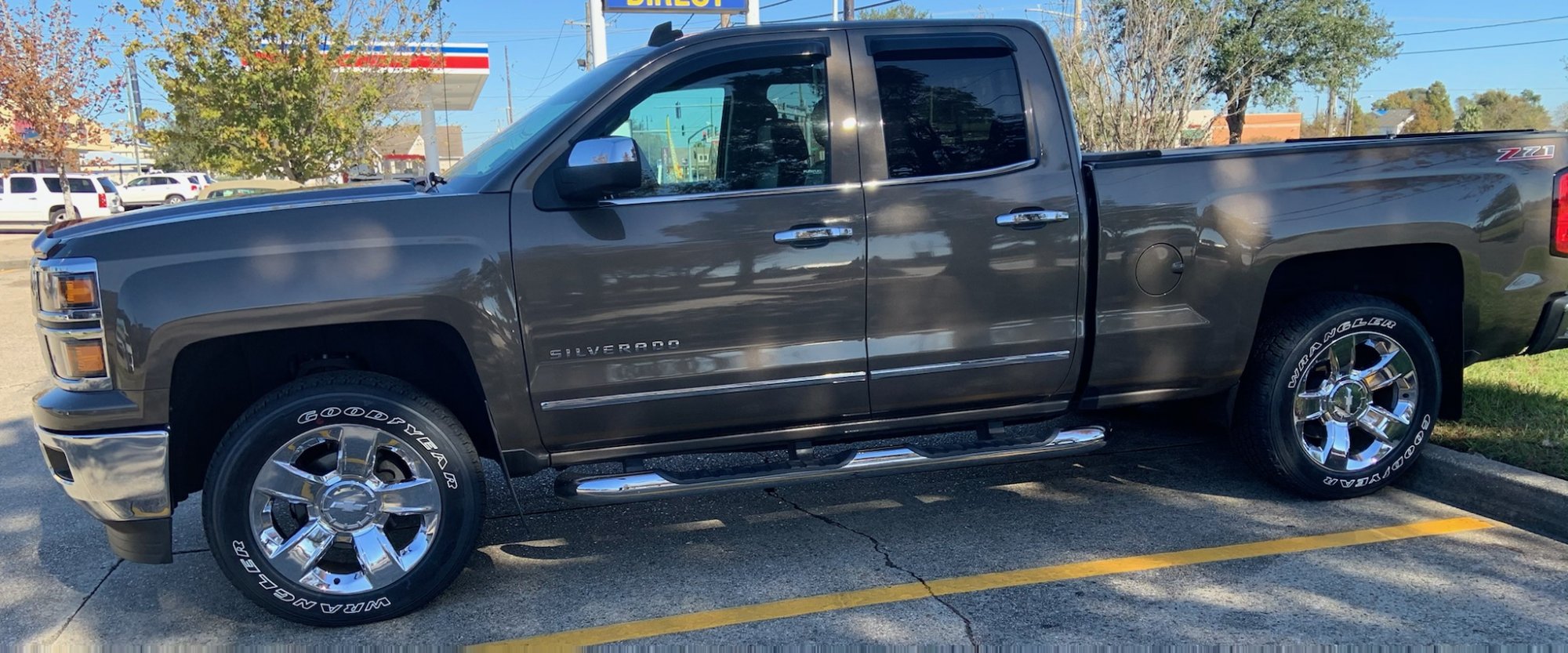

  17. White letters on 20" chrome wheels. These are the Adventure A/T with Kevlar:
