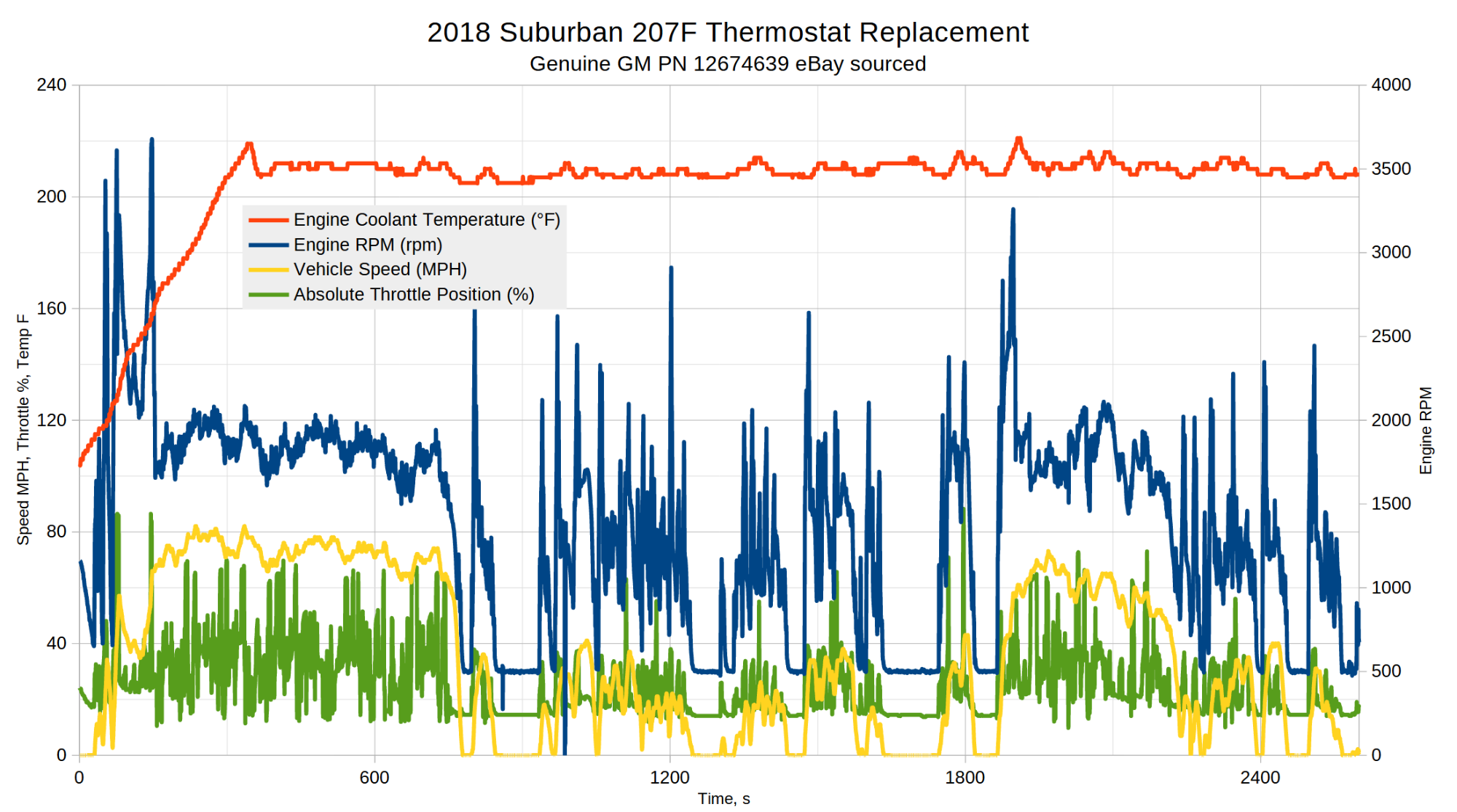

So the new thermostat came in on Thursday and took it to a good local shop on Monday. Just short trips on Monday, but finally had a nice 40 minute drive today and it seems solid. Mostly stays dead-on at 207F actual in light driving and 50 degree outside temps. Forgot to take a photo of the one that came in, but it was a genuine GM part complete with GM and part number stamping, taken from a full water pump assembly as described in the eBay listing. What a freaking hassle, but glad it's finally fixed! The guy on eBay still has plenty of these if anybody needs them. $199 is a ripoff (I paid $149) but it is what it is when you can't get them elsewhere: https://www.ebay.com/itm/115727184809 You can get the full water pump assembly from which he's taking those from for only $50 more from Rock Auto, and elsewhere. Just remove the thermostat if that's all you need, and sell the water pump or keep it as a spare. https://www.rockauto.com/en/moreinfo.php?pk=10622996&cc=3438969&pt=10178&jsn=492 40 minute drive log attached. It's working as it should so not going to do another cold start test and waste more gas. -

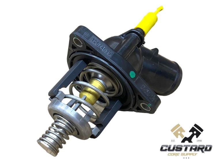

This is off that listing. Has GM and correct part number stamped into the housing. I bought another one that was listed as a Genuine GM part from another seller just in case. If the first one works out and I don't end up needing the backup, will either return it or re-sell it here in the FS forum. What a CF!!!! -

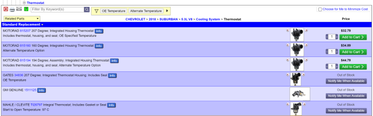

I think it's due to the strikes, to be honest! Saw this on a parts website. I might just have to put the questionable MOTORAD in it for now. -

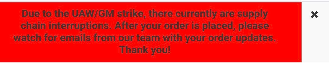

UPDATE finally got through to the parts counter guy at my dealership. He confirmed the parts are "massively backordered" and that they have 8 on backorder right now, but no idea when they're coming in. FFS. -
