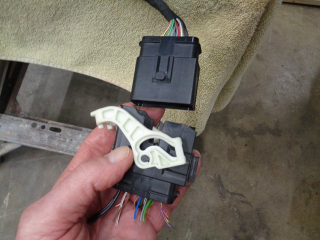

  1. Look under the passenger seat carpet under the seat,there should be a large connector under there feeding the jump seat.That will connect to the new console if it's there assuming they don't cut the one on the new console if it's a salvage one when they remove it. On the floor console there is a small extension harness under the top panel that then goes back to the dash.This is the area that you have to modify with new parts to make all of the console ports work as designed.The dash ports change from a USB A,USB C,SD card module to just a USB A,USB C and moves the SD card to the console via the ext. harness.
  2. Might not work if you don't have the harness under the passenger seat to start with,Casey and I both started with LT Silverado's that have the jump seat harness.

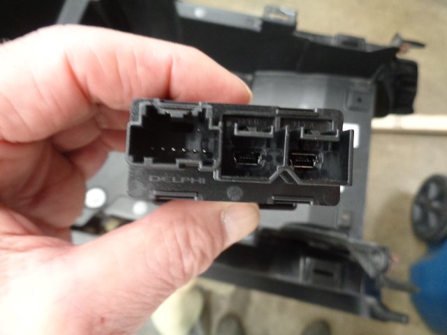

  4. Can't say for sure it will work til I get my parts (waiting on the ext. harness GM part # 84376073 and the lower trim piece GM part # 84127263)They're not on BO just really slow shipping. I'm starting with an LT model which has the large plug under the passengers seat and a jump seat with storage. I talked to Casey on the phone and he said he started with the same model truck,the console he bought had wireless charging and mine doesn't. When he first did the install he couldn't get the USB or SD card to work inside the new console. He replaced the existing dash USB/SD hub with GM part # 13529873 which is only a double USB hub and has a line to feed back into the console all done with the ext. harness. He said that that change made the SD card read in the console and the USB port became a feed/reader and it all worked as designed,said his wireless charging worked too,with the dash USB good also.
  5. According to another member Casey you need to switch the USB/SD port on the dash to a different one and then connect the extension harness for the floor console to it for it to work.I have part numbers for the USB port and the extension harness that Casey shared with me but have not done the install yet as I'm still waiting for the harness and a trim piece to get shipped to me,so I can't guarantee it works.

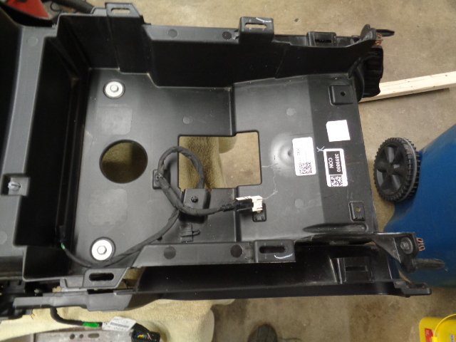

  8. This shows some of the steps for the console.There are additional parts needed to make the swap complete,trims piece for the dash and swapping out a USB port if you don't have a jump seat with storage to start there may not be wiring under the passenger seat for the new console.
