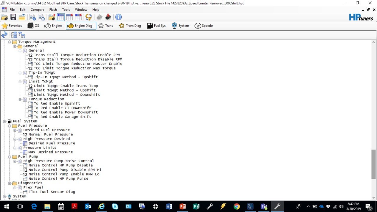

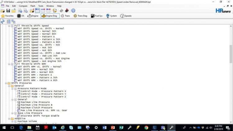

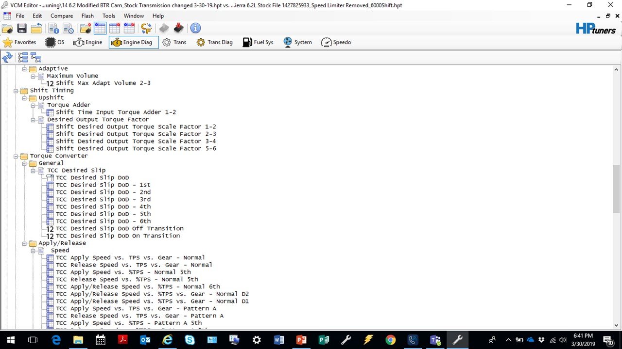

It took hours any many revisions to fix the driveline clunk issue I experienced. It is a combination of upshift and downshift scheduling problems, torque converter lock up and unlock at the wrong times, desired output torque factor issues, torque adder issues, stall torque management, tip-in torque management, limit torque management, torque reduction, and more. Basically the stock tune is commanding too much of everything at the wrong times. Mine shifts like butter at part throttle and is nice and crisp at WOT. The way it should of been from the factory. -

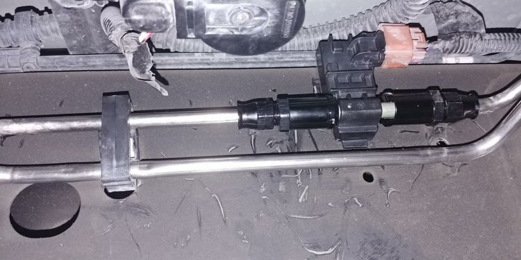

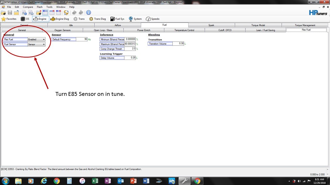

Correct add sensor in fuel line and connect it with truck harness. The harness connector is on drivers side frame rail by transmission cross member.

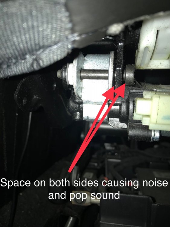

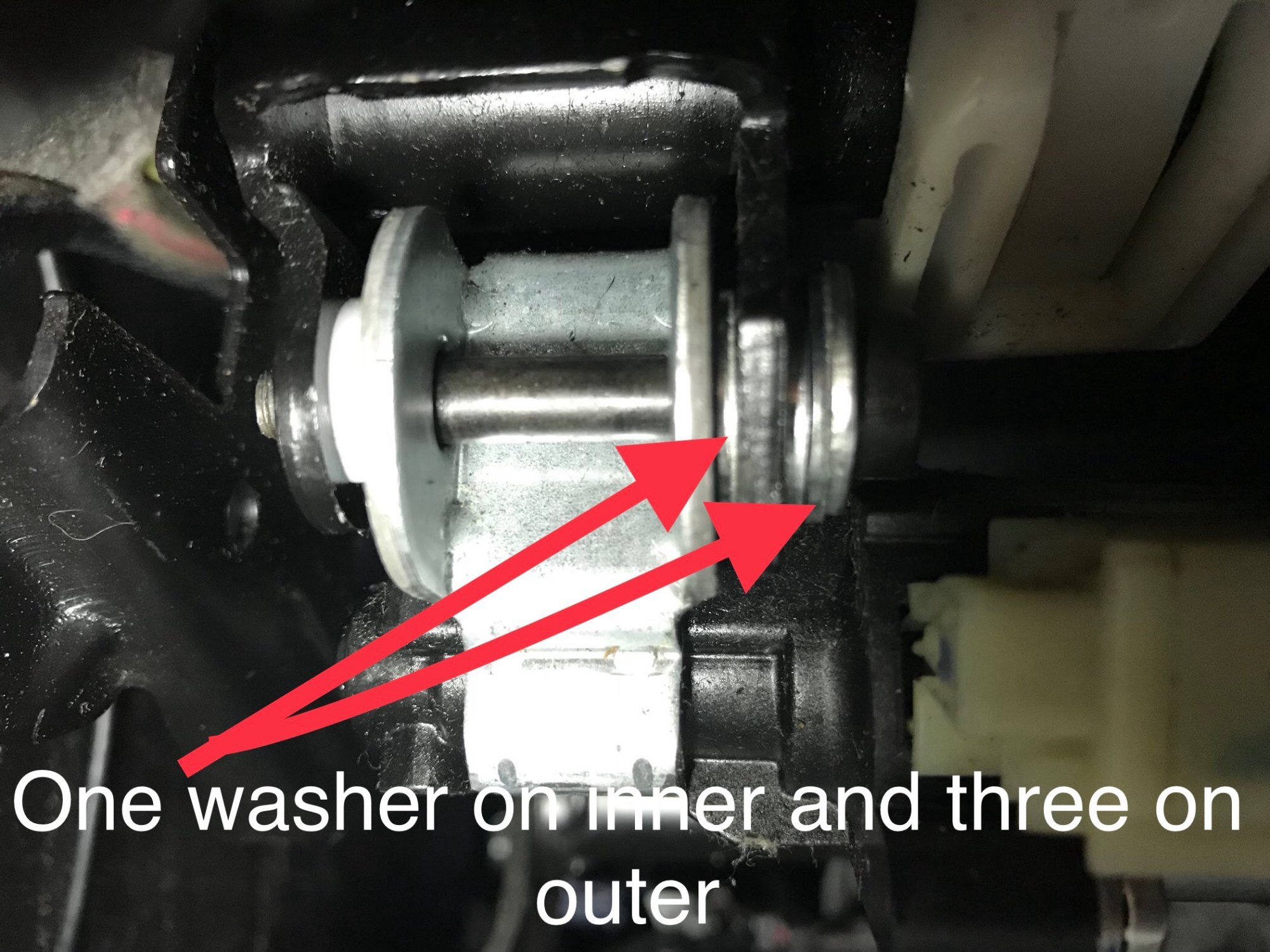

My seat was very loose side to side and front to back, it also made popping and creaking noises especially when making turns with truck. After several trips to Dealer and paying for a half baked repair I had enough. I fixed my self and Installed washers on seat adjuster that moves the seat up and down and seat bottom tilt. The factory bolts threads bottom out and do not allow a tight fit and even with the plastic spacer the Dealer puts in per the bulletin there is still excess play and movement. See pics below with space I am talking about and pics on how to fix. I checked several other seats and they all have the same issue. This is a design flaw from the factory and I can't believe they have not addressed it.
