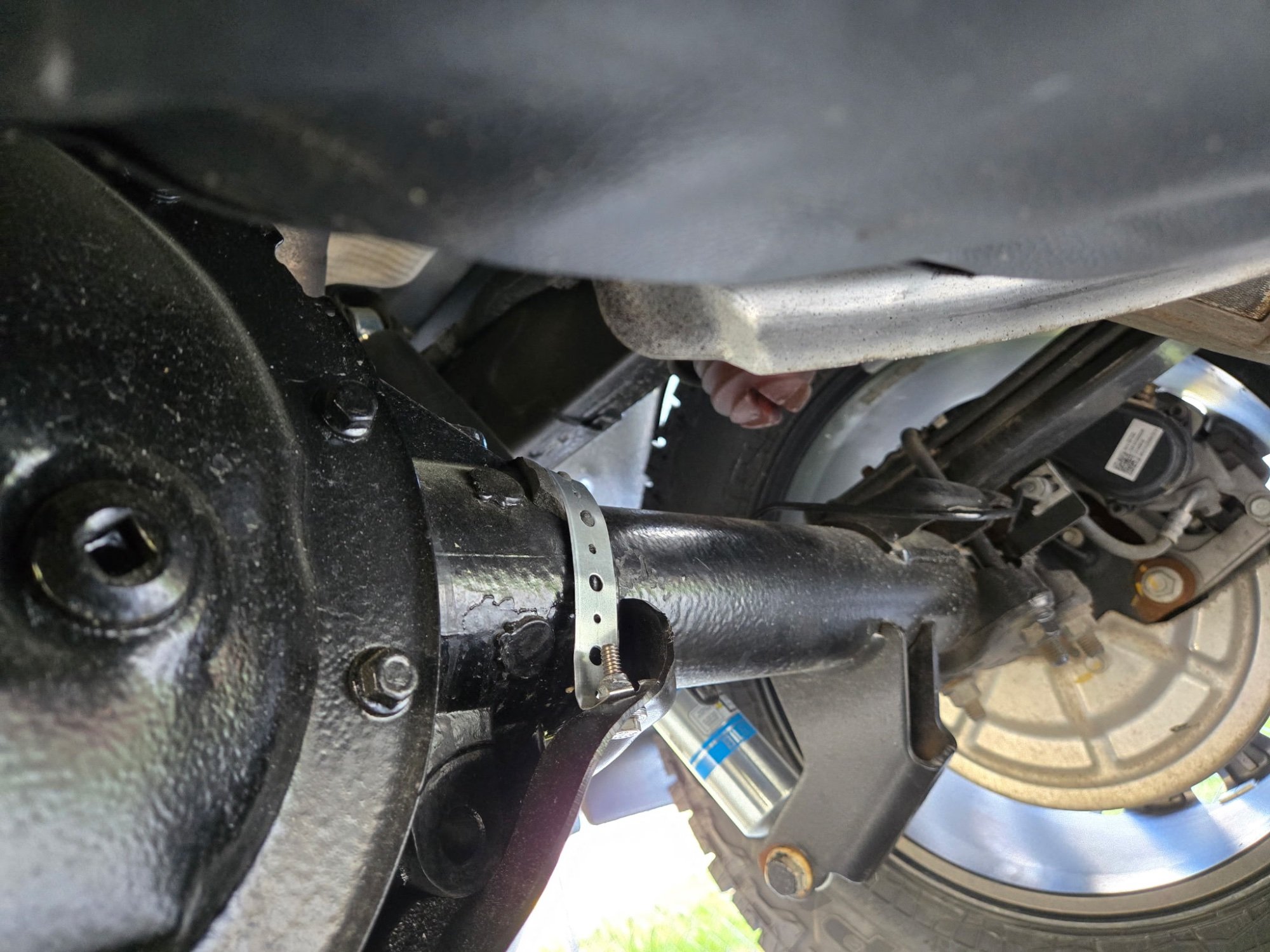

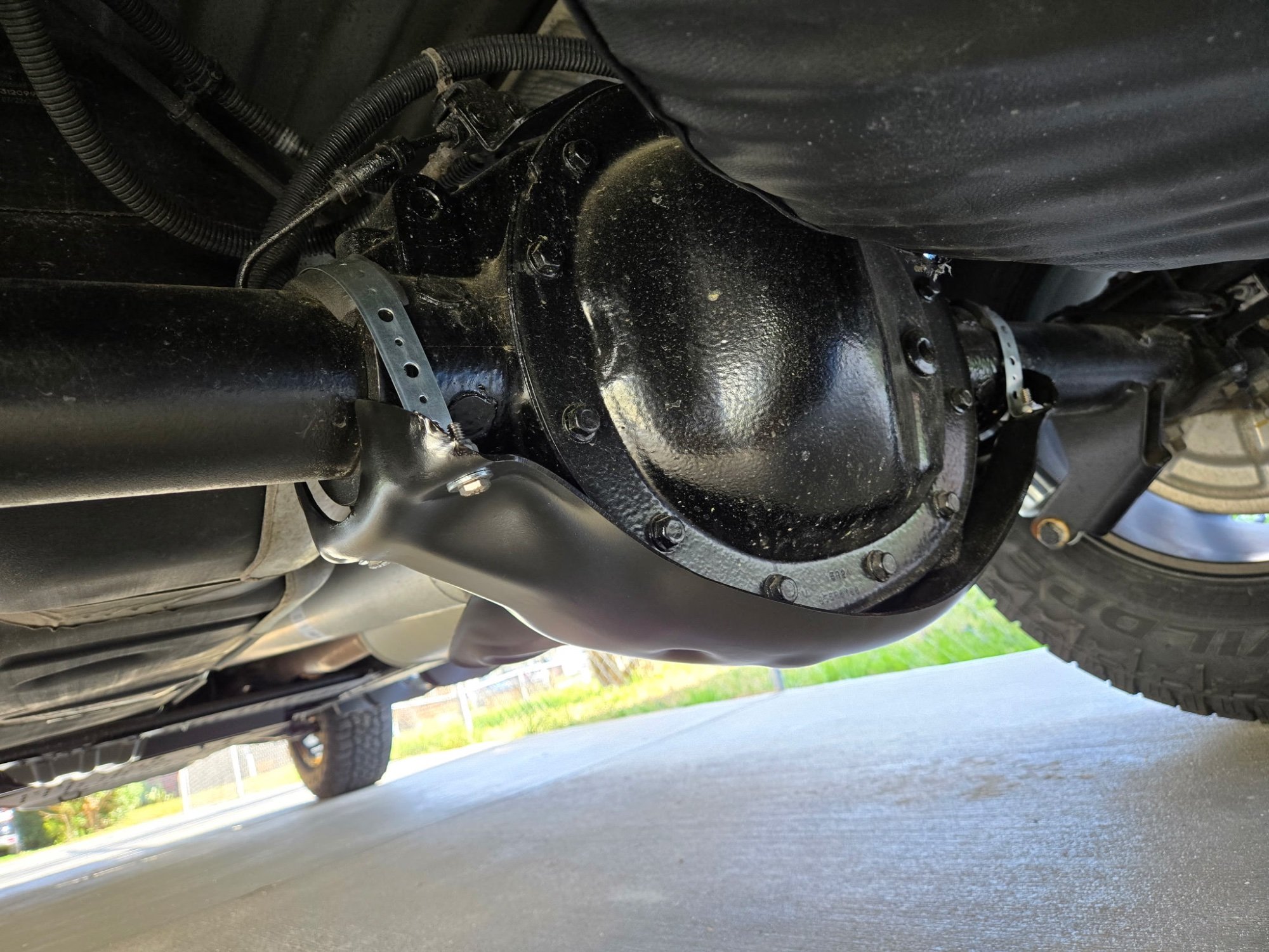

I may still do a differential cover, just for extra protective measures… The terrain I’m going over is really rough, I’m even going with shock skid plates. If I lose the plate while sliding over a rock, I have plenty of strapping to replace what came off… That’s why I’m not too terribly worried about it. I’m just trying to protect the differential as much as possible. Unfortunately, they don’t make brackets for the SU8, and I wish they had. I could probably modify these, but it would take quite a bit of time, and I’m not sure that I want to go through all that. I’d rather just use the plumbing strap, and double or triple up on it to make sure it stays on the truck. -

It did. Problem is, the brackets don’t fit the SU8 diff. It’s a different shape, but the dimensions are all the same. If the U-bolts were about an inch longer and the bracket was a different shape, it would fit perfectly. I think I might take some time and double up on the straps to ensure a good, sturdy system. -

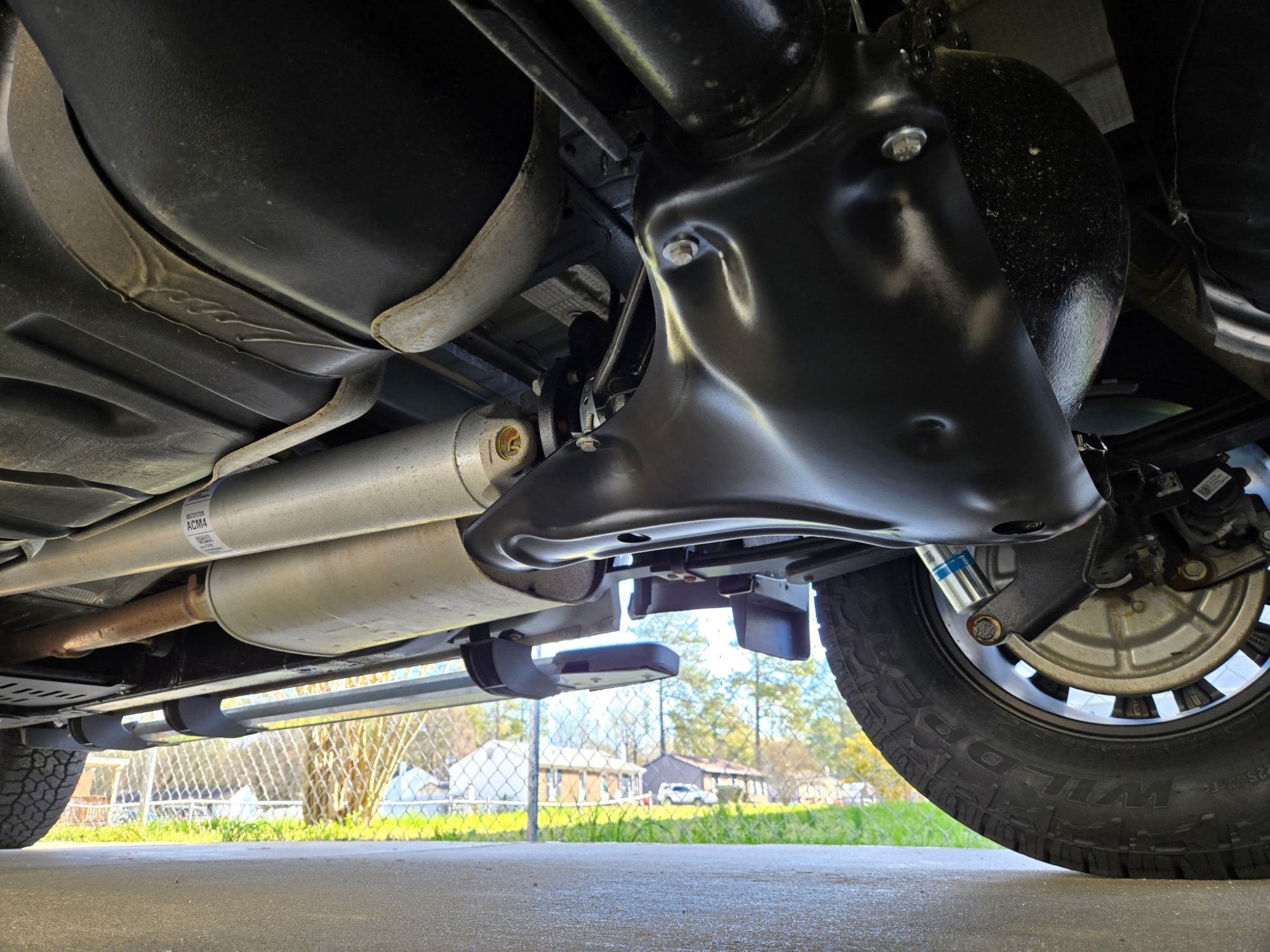

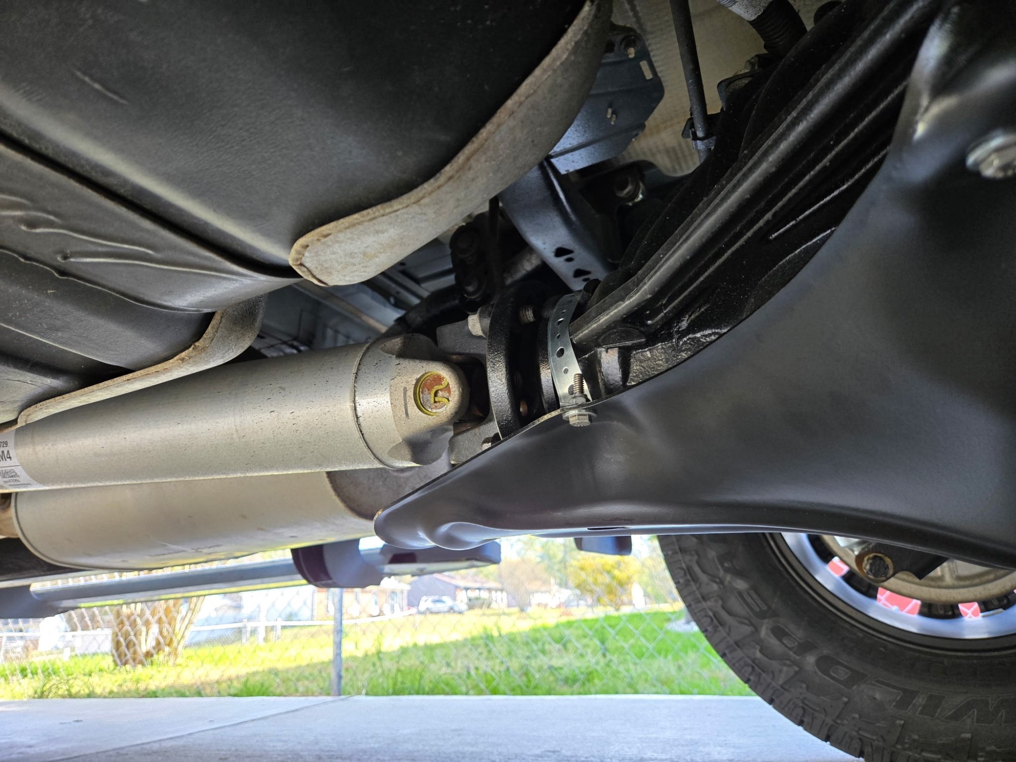

So, I did some modifying. Used pipe straps to hang it and foam under the strapping and the plate to insulate it against rattle. It fits. No cutting or modifying necessary. -

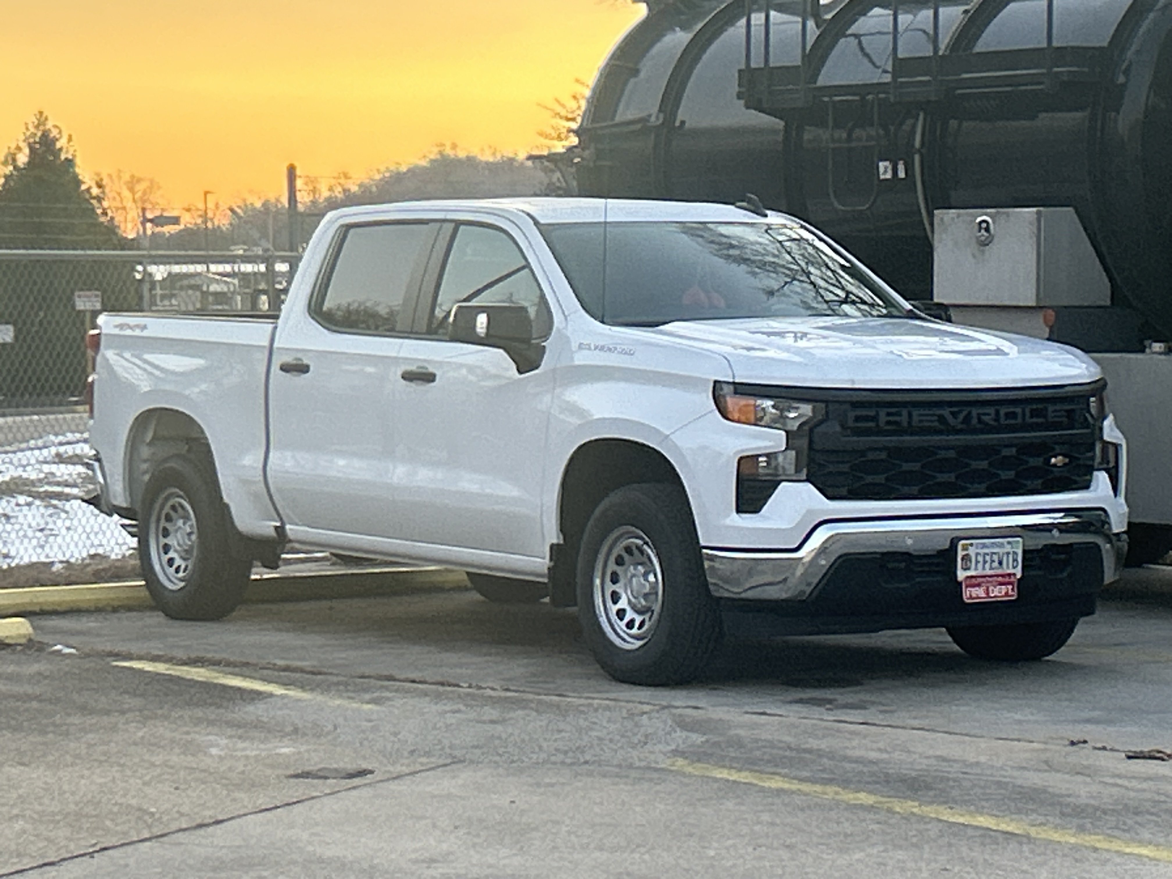

Hey boss, just wanted you know I recently did this with my 2024 w/t 1500. If you use a 1” shackle in the rear with trail boss struts up front, it sits level. I’ll send comparison photos. Also keep in mind, I went from 255/70R17 tires to a new set of wheels and 275/70R18’s to match the ZR2. the factory ranchos are super spongy and a lot like the shocks that came on the Silverados that didn’t have special packages. I had a set that wore out completely at 25,000 miles. Skip the ranchos and get the Bilsteins. You’ll save money and get a better, longer lasting product. the 2” lift also comes with CV axles. YOU DO NOT NEED THESE if and ONLY IF you are just going with the 2” lift. If you go any higher in the front, you need the CV’s AND upgraded upper control arms. PLEASE keep in mind, I swapped the grille, added the side step bars, rear fender liners, removed the air deflector on the bottom of the front bumper, and downgraded license plates to avoid paying the government more money than they absolutely have to have…..but I promise it’s the same truck. There is more than a year’s difference between these two photos.
