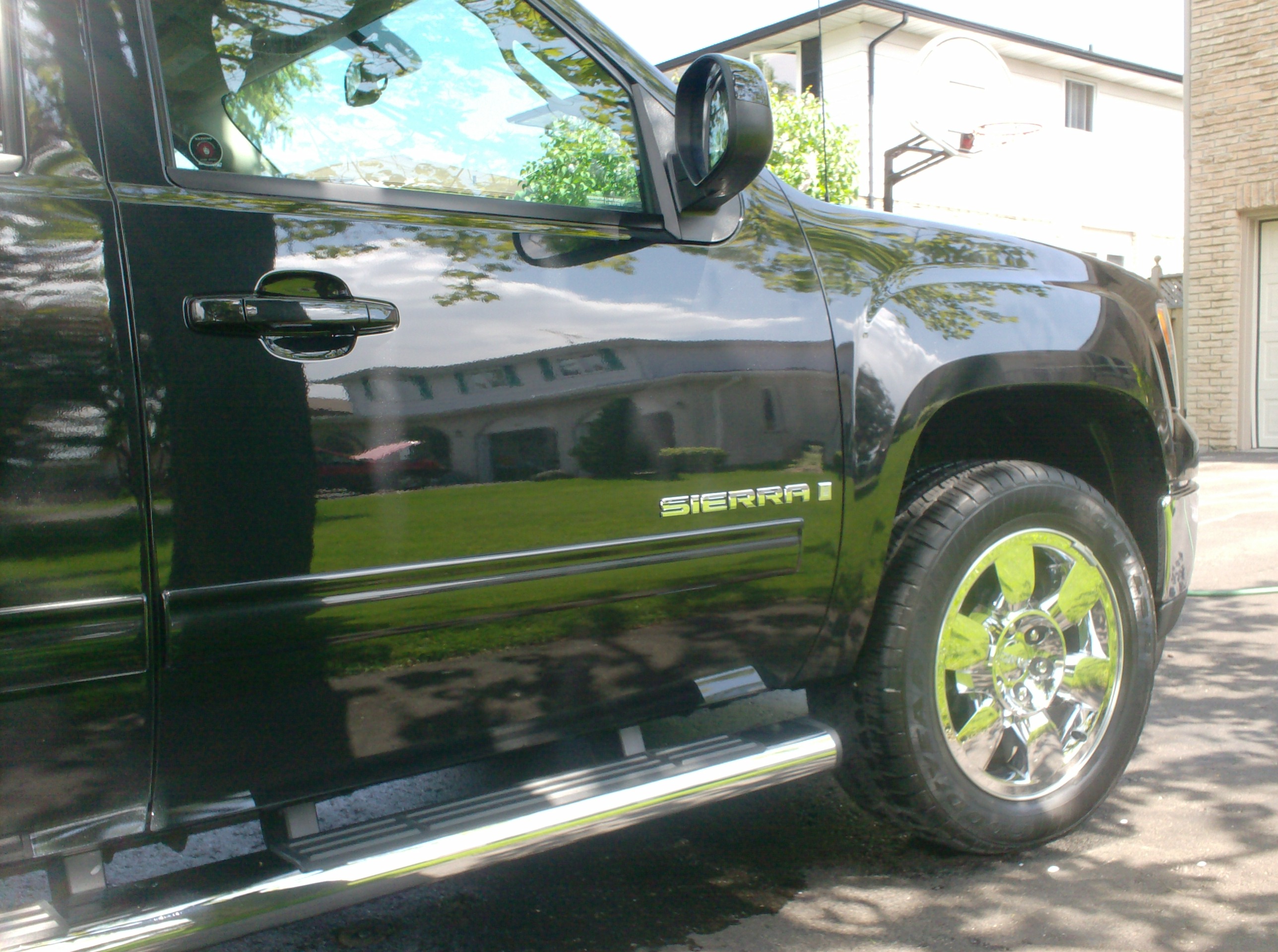

My new 09 Sierra with the new style 20inch wheels vibrate pretty bad at 100 to 120km's/H, it did it before I had my left front wheel replaced and now it is doing it worse?
I noticed with the new wheel, they put 2 huge outside weights on and the passenger side has 1 big one.
Anyone else have similar issues with the new style 20's? If so, was a simple rebalance enough to correct the problem?
Also curious why GM puts their weights on the outside of the rim, can they not use inside the rim stick on weights?
