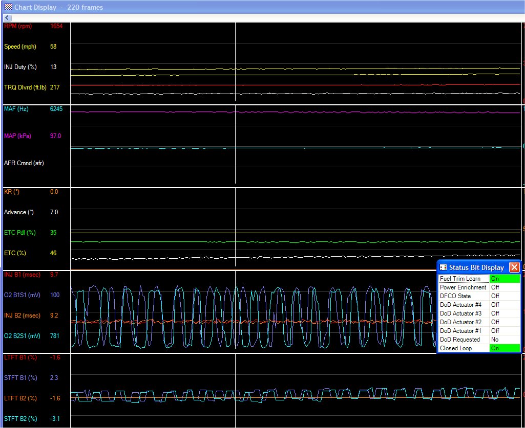

The first truck I drove had it, and this one does too. I'm positive it is not something mechanical, but not sure what would cause this. A bad pedal position sensor?
No KR going on at the time.
No, it is not AFM kicking in and out.

That's actually exactly what it feels like to me...a bad or loose wire or fowling plug. I already checked the wires for proper installation...should throw a multimeter on them. Hell, I've got a spare set of MSDs that'll probably fit.
I'll be taking her in soon anyway, so I'll have them check it. I'm not overly concerned about it...just strange if you look at the log.
The throttle blade is actually vibrating in the throttle body, so something is actually commanding it to do what it is doing...weird.

What I mean is look at the image I posted. You can see where the throttle itself is being held steady, but the ETC itself is jumping all over...same with the injectors, MAP, delivered Torque, etc.
I need to go back and make sure I'm logging the right throttle PIDs. There's a dozen or so, and they all show something different...be it pedal position, where the throttle blade is commanded, and where it actually is. Something is making it jump all over the place.
I haven't logged for misfires yet either.

Right.... though every log I've ever done has exhibited the same kind of thing. I just assumed that was "normal" to see at idle, but maybe I've been looking at the wrong parameters all along, too.... :lol:

Just to be sure - the log (image) I posted above is not at idle. All that "vibration" of the Injector Pulse Width, throttle, timing, delivered torque, and MAP is not normal. If you were to look at the logs or when I get a chance, you'll see that it doesn't normally do that...those lines are smooth.
The log I posted (at the very end of it) was the worst of this "miss" I could duplicate...that's why I stopped it where I did, so it would be easy to find. Couldn't duplicate it on the way home from work today.
