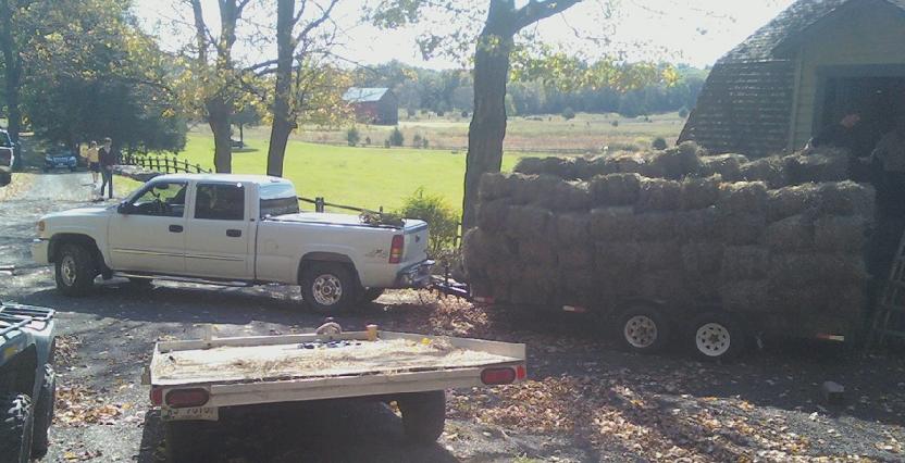

i was towing some hay last weekend, and the truck did great on the back roads. but it seemed like when i got on the highway and hit around 60+ that the truck had a real hard time pulling. say going up a hill, or i need to pick up a little speed id get on the gas it would rev up, but nothing would happen. it just sit there reving didnt feel like it pulled any harder or anything.
do you guys thing i had to heavy of a load? it was a 16ft utility trailor and we had 130 bales of hay, so say 7500lbs tops being towed.
the trucks completely stock other than 265 75 16 tires.
