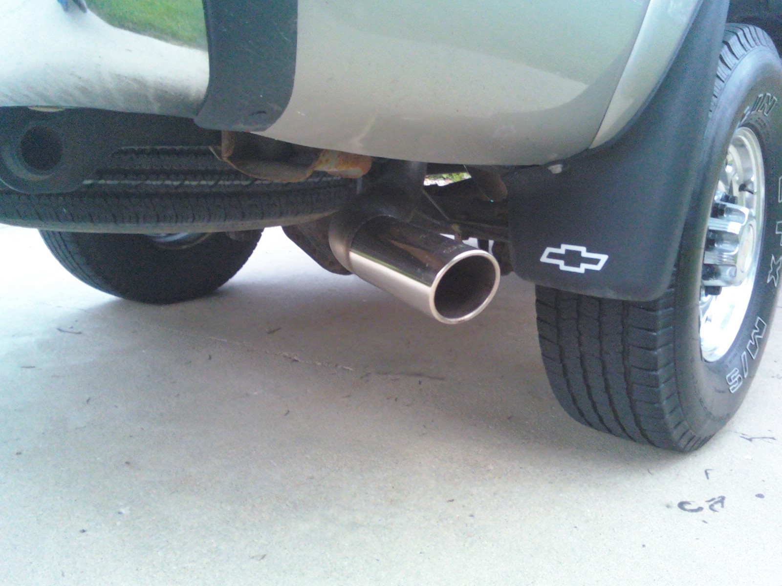

I left the kitty's on, your stock exhaust is only 3" from muffler outlet - tip. All in all the stock exhaust is very well made and will last a lifetime, but lacks the aggressive sound and T-304 SS. Consider having it welded on, I intially had mine installed with the clamps it came with, but it started to leak later on, so then I had it welded.

My last truck I did the rear bumper exit, but this one I wanted to do the side exits on each side. I think it looks better and alot of trucks that have after market dual pipes didn't have this look at the time. Also make sure you purchase a stainless steal package, I opted for the T-304 stainless steal which cost a little more. My prior truck I didn't get SS (actually don't think they offered it at the time). Anyway, within 4 years rot destroyed one of the pipes and the muffler was also starting to show signs of rot. Also if you do side exits like mine, if you don't have mud flaps on rear wheels, consider putting them on. Even though they tend to look not so good imo, they will help protect your pipes and body panel.
