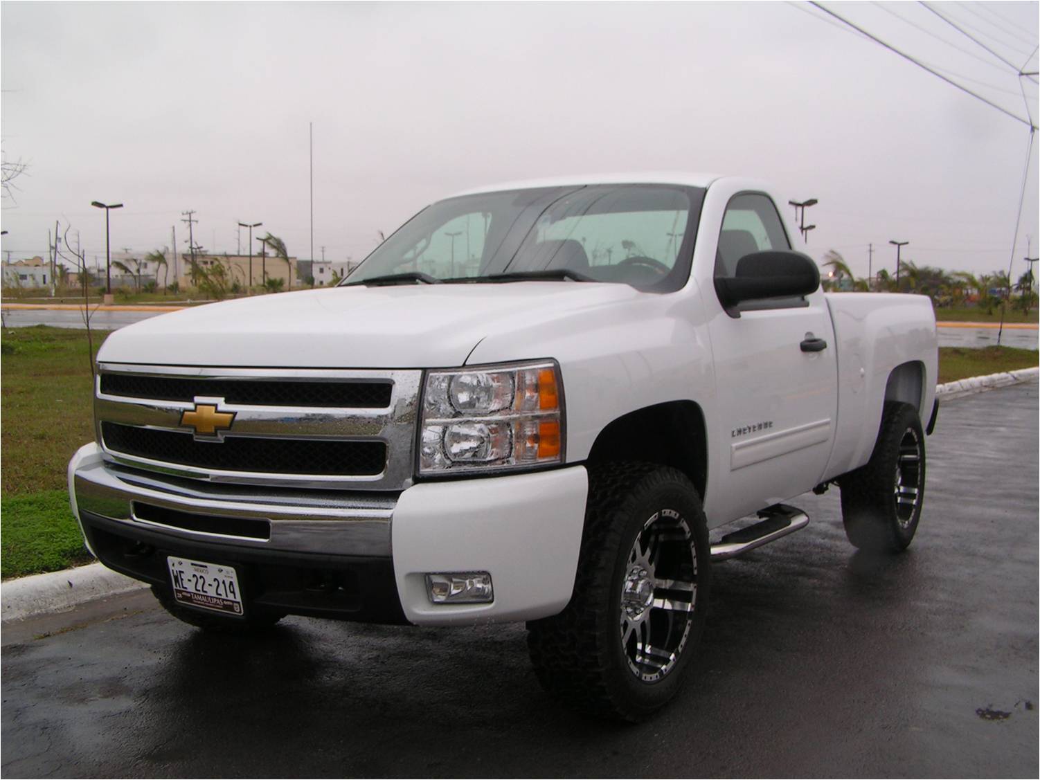

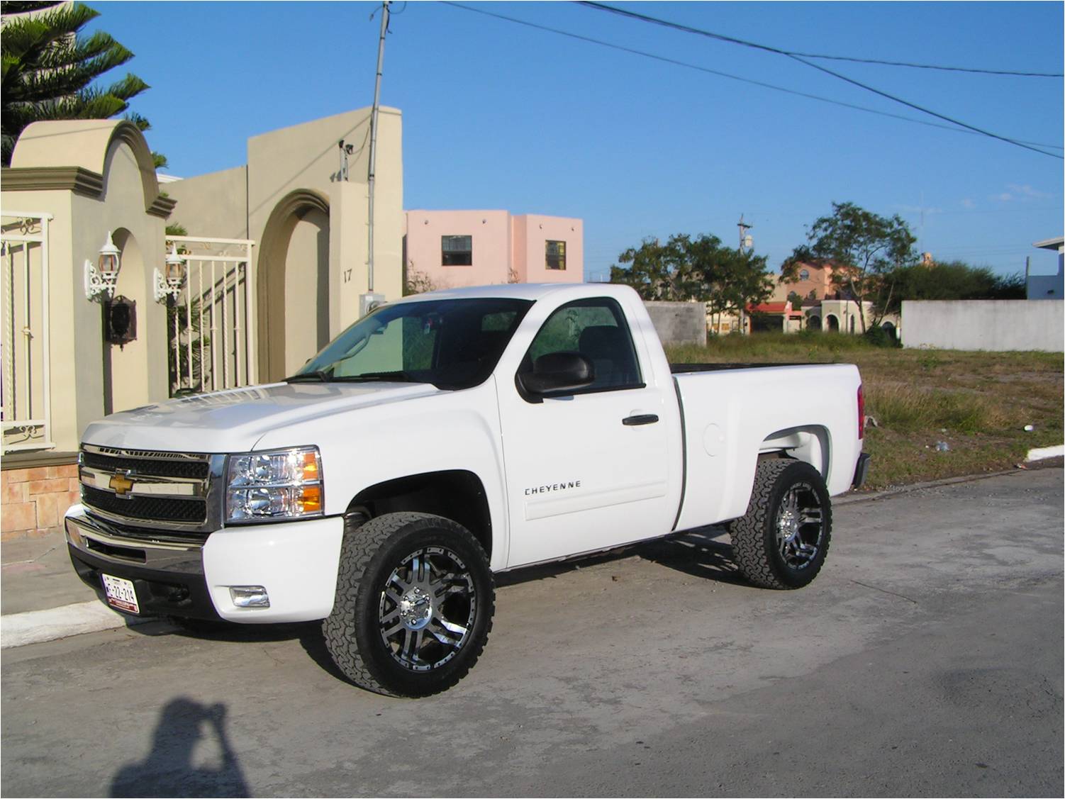

These are the only before pictures I have
...do you guys have any before and after pics to post?...
Rough Country 2" Leveling Kit...
Before:
After:
Before Close-Up:
After Close-up:
