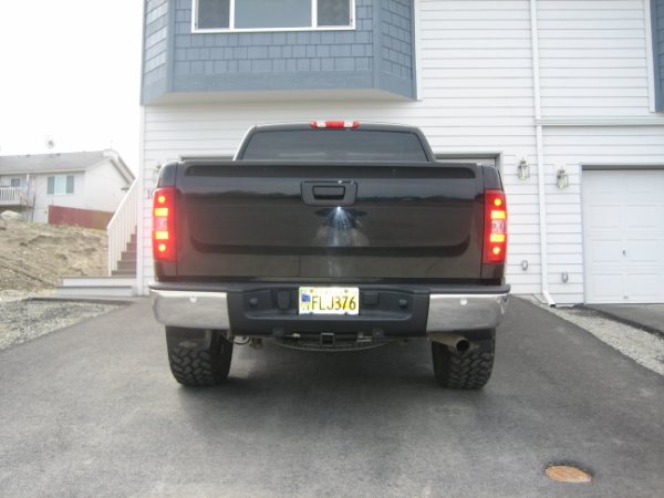

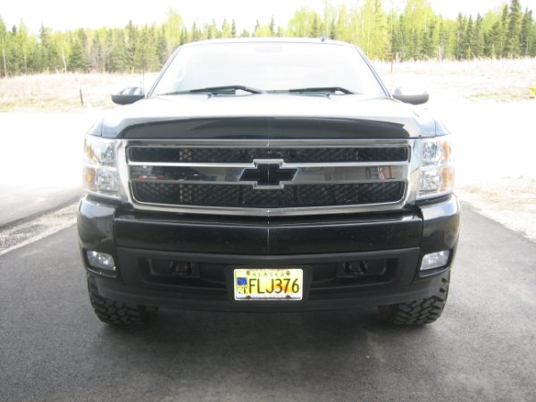

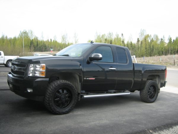

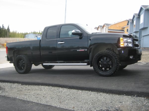

Made some improvements about a month ago. Here are the specs:
Eagle Alloy 069, 20x9, +20mm offset, 5.725 backspace
Nitto Trail Grappler 295/55/20
Truxxx level/lift kit, part #406035
Very minor trimming on the front inside mud flaps
Thanks! The side moldings were easy to take off, but the sticky residue was a pain in the ass! Ended up taking it to a body shop and they cleaned it up for me. Cost me $150.
Yeah, tried goo gone and a couple other things with no luck. The sticky stuff was coming off slowly, but you could definitely tell where the molding used to be compared to the rest of the door.
