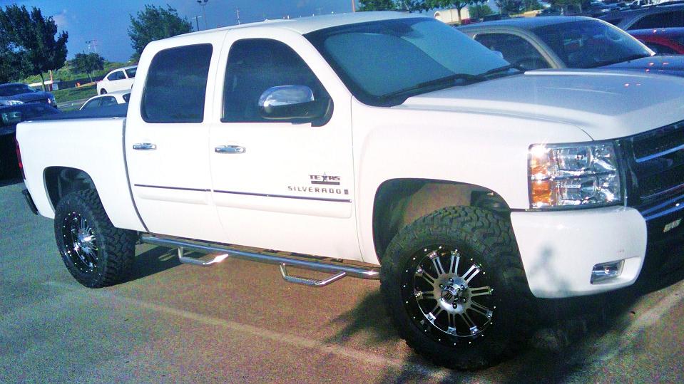

That looks really good. You just have the RL 2.25" leveling kit and 3" rear block, right? No rubbing or trimming?

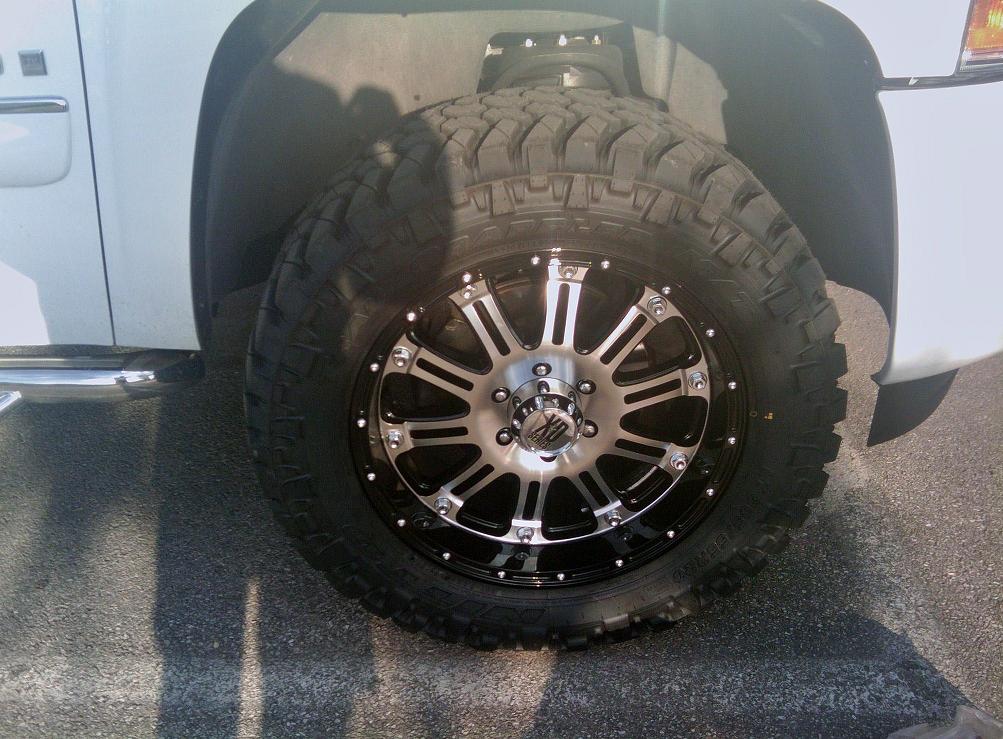

Yes on leveling kit and rear block with new tires. Pic with original rims is just leveling kit.
There was slight rubbing at the inside fender wall in the behind the front wheel, moved the rubber fenderliner and the tire shop trimmed about a 2" long and 1/2" deep metal trim, they then used zip ties and pulled the front and rear fender well out, you can see it alittle in this pic. The reason we trimmed it it rubbed while turning and going over a bump.
After fix, no rub at all. It took a whole 10 mins and a cutting wheel to fix the problems
my wheels are 20X9" with 18mm offset and 305x55x20. if I went 295x55x20 there would have been no rub and no trimming.
