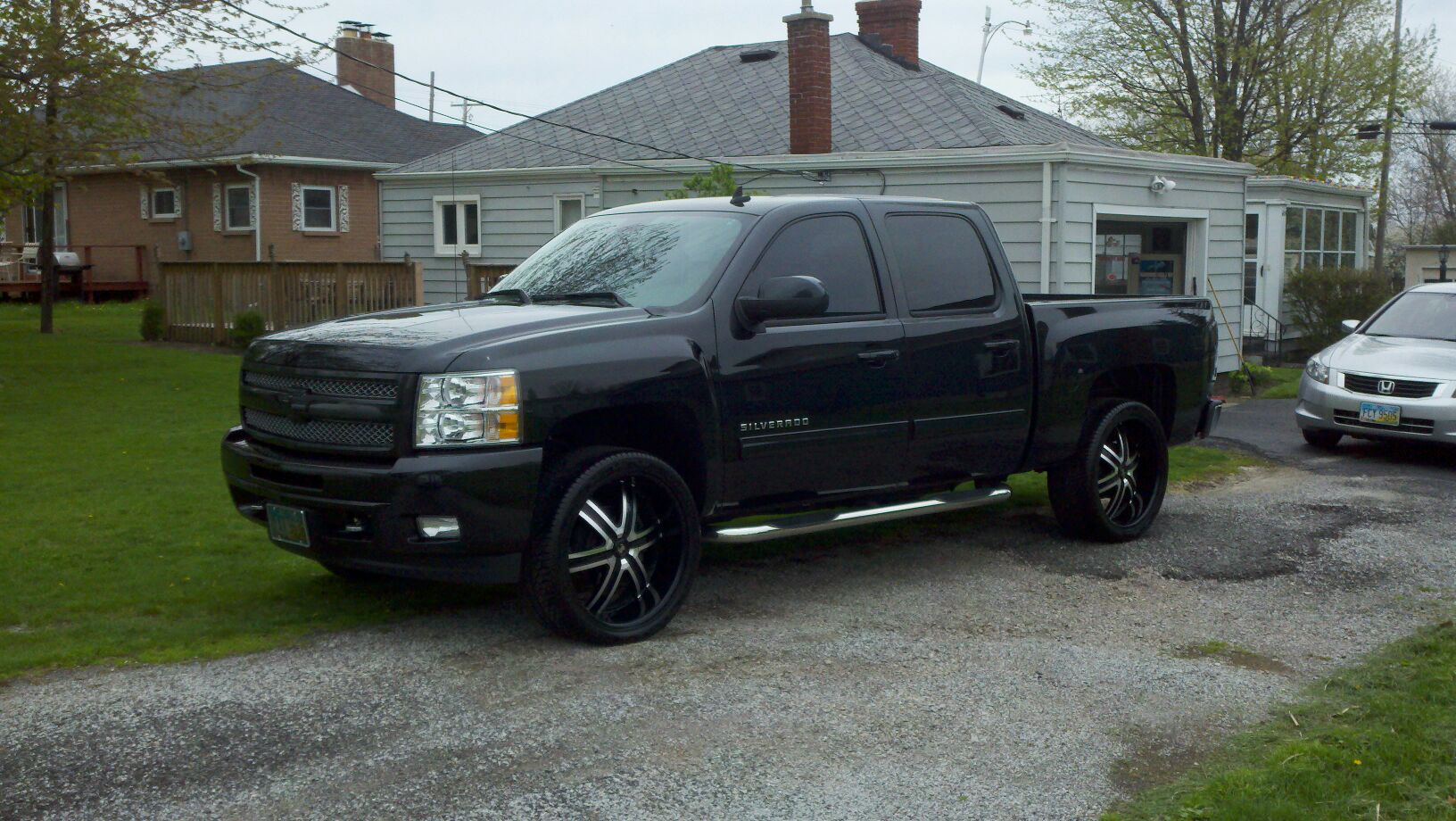

I have a 2010 silverado crew cab with a 2 1/2 leveling kit and want to get 20 inch rockstars for it and nitto mud grapplers, but do not know a good size of tire to get. Please post pics and tire sizes please.
20's with a zero offset and 295/55/20 size tires. put a 2.5 level on your truck first though. You will have to trim some of the plastic fender liner and might have to bend some metal but it's not as bad as it sounds
That looks very nice....the exact look i was going for. I was thinking rockstar rims and nitto mud grapplers, just wasnt sure on the size....do you think a 285 tire would fill the wheel well good without doing any mods as far has cutting fenders? I already have a 2.5 inch leveling kit on the front.

No comment to what to run other than to agree with the 275/60...
as to the setup in this pic, i think this looks pretty nice, whats the wheels and tires? With your 2.5" level did u put another block in the back or were u alright with the stance?
