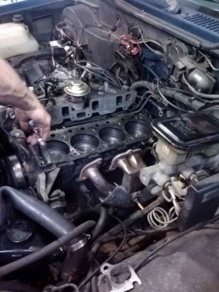

well as a update i have done some major changes here, i know this part of the forum dosent move much but hoping someone can help me here before i unload this thing , i actually like this truck just having some issues .
so i cleaned the tbi unit (700 series) it was all gummed up and figured that was the cause of a possible vacume leak. Nope ...replaced numerous vacume lines put new ends on the vacume lines. Put the truck in the air ..no converter to have a issue with. Then i started thinking intake egr..ect so since i have to have all the stuff around the head off i sent the head out to get "tanked" and "shaved" head came back tested good nothing wrong.
replaced all the gaskets during this....change the oil..then started her up...started right up..now i got a lifter tap or something but other then that still have the "idle surge". im at a total loss!!! No idea whats going with this thing. i litterly have replaced all the parts on this thing minus pcm,iat, instrument wiriing and related.
anyone have one of these....remember GM only made the "A" motor for a few years like 90-93 i beleve and an 4 banger auto is even harder to find. i may be out of luck..lol thanks for reading.
